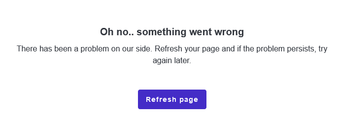

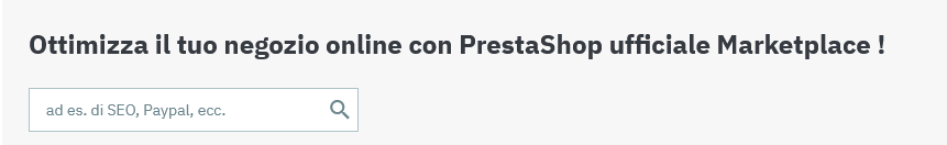

fedesib Posted December 7, 2023 Share Posted December 7, 2023 Hi everyone, I'm reopening this old thread because the "trick" summarized by @CarolineinTo does not work anymore in PS 1.7.8.10 since there's no search bar in Modules Catalog even if you disable the connection to the Addons (by disabling the module "PrestaShop Marketplace in your Back Office"), so there's no way to "search" for your uploaded module, or at least I didn't find one. The official page in Prestashop Addons says that the module uploaded via FTP should appear in the modules list (https://addons.prestashop.com/en/content/13-installing-modules) but as far as I know it has never happened. Any suggestion? Thanks for your time, Federica Link to comment Share on other sites More sharing options...

Mediacom87 Posted December 9, 2023 Share Posted December 9, 2023 Hi, This problem is quite annoying. Yes, it's nice to have the modules you use the most appear first, but not being able to view uninstalled modules in the list of modules is really a mistake, in my opinion. On the other hand, all you have to do is go to the Modules Catalog section and do a search using the name or simply the first letters of the directory name of the module you've just uploaded via FTP, then it will appear and you'll be able to launch its installation and configuration. This procedure irritated me so much that I integrated the option to install, uninstall, delete, download the archive of a module directly into my module, enabling me to clean up a PrestaShop installation of outdated or unwanted data. 1 Link to comment Share on other sites More sharing options...
fedesib Posted December 9, 2023 Share Posted December 9, 2023 Hi @Mediacom87 thanks for your polite answer. 1 hour ago, Mediacom87 said: On the other hand, all you have to do is go to the Modules Catalog section and do a search using the name or simply the first letters of the directory name of the module you've just uploaded via FTP, then it will appear and you'll be able to launch its installation and configuration. This was exactly what I was doing successfully before PS 1.7.8.x versions (it is extremely handy to install modules by uploading your files directly in the /modules folder while you are developing your own). My problem with PS 1.7.8.10 is that there's no such search bar anymore in the Modules Catalog section. If you have "PrestaShop Marketplace in your Back Office" enabled you can only search in the Addons (not useful in my case), if you have it disabled here's what you see (or what I see at least): The other Tab (Modules Selection) shows only Addons Modules and using the search bar redirects to Addons pages: The "old" search bar that permitted to look for modules in the /modules folder and showed the ones you uploaded as free has somewhat disappeared in PS 1.7.8.x versions: as far as I remember it was there in versions 1.7.6.x, I cannot remember about 1.7.7.x versions. If you have any suggestion, code patch or any workaround I will be more than glad to test it. Thanks for your time, Federica Link to comment Share on other sites More sharing options...
Mediacom87 Posted December 9, 2023 Share Posted December 9, 2023 I don't know how to answer you, I don't have any modules linked between Addons and my store, yet I do have access to the module catalog and can easily search for the modules I've uploaded to my FTP. Of course, the module code must be compatible with your version of PrestaShop and there must be no errors in the module in question. Link to comment Share on other sites More sharing options...
fedesib Posted December 11, 2023 Share Posted December 11, 2023 @Mediacom87 Thank you for your answer and for your time. I finally solved it: I had to completely uninstall (and not only disable) the "PrestaShop Marketplace in your Back Office" module (ps_mbo) that comes installed by default on the new PS 1.7.8.10 -> This gave me back the "old" Modules Catalog page with the search bar and everything instead of the error page and my custom module shows up as it should. Thanks again and have a good day, Federica Link to comment Share on other sites More sharing options...
