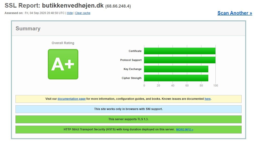

John Overby Posted August 23, 2020 Share Posted August 23, 2020 (edited) I'm using the 3.14.2 module, and also gets this "TLS version is not compatible" message. But that's not all. When the module is active, I get this "site not secure" and a orange triangle on the lock in the browser. (see attached picture) I've tested the site at https://www.ssllabs.com/ssltest/, and it runs TLS ver 1.3 and everything else seems OK. Any suggestions will be of great value. TIA Edited August 23, 2020 by John Overby Wrong spelling (see edit history) Link to comment Share on other sites More sharing options...

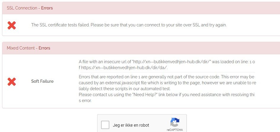

John Overby Posted August 31, 2020 Share Posted August 31, 2020 On 8/23/2020 at 10:40 PM, SwissGroove said: On which URL? This should be related to Mixed Content. You can check the URL on https://www.whynopadlock.com/ to see which element causes the issue in order to fix it. Should have added the URL, but here it is: https://xn--butikkenvedhjen-hub.dk/dir/da/ this URL cannot be tested with the NoPadLock page, but if i use the original https://www.butikkenvedhøjen.dk/dir/da I get the attached result. The main page this Prestashop resides on, have no problem with the https. https://www.butikkenvedhøjen.dk Thanks for your effort so far. Link to comment Share on other sites More sharing options...
SwissGroove Posted August 31, 2020 Share Posted August 31, 2020 Hi, I can see 3 URL's in the source code of your page starting with http:// instead of httpS:// which causes mixed content. http://xn--butikkenvedhjen-hub.dk/dir/http://xn--butikkenvedhjen-hub.dk/dir/da/stores http://www.butikkenvedhøjen.dk/dir/cookies.html You should check your website files or editor to see where these URL's are exactly added. Then change the URL's to httpS:// Link to comment Share on other sites More sharing options...

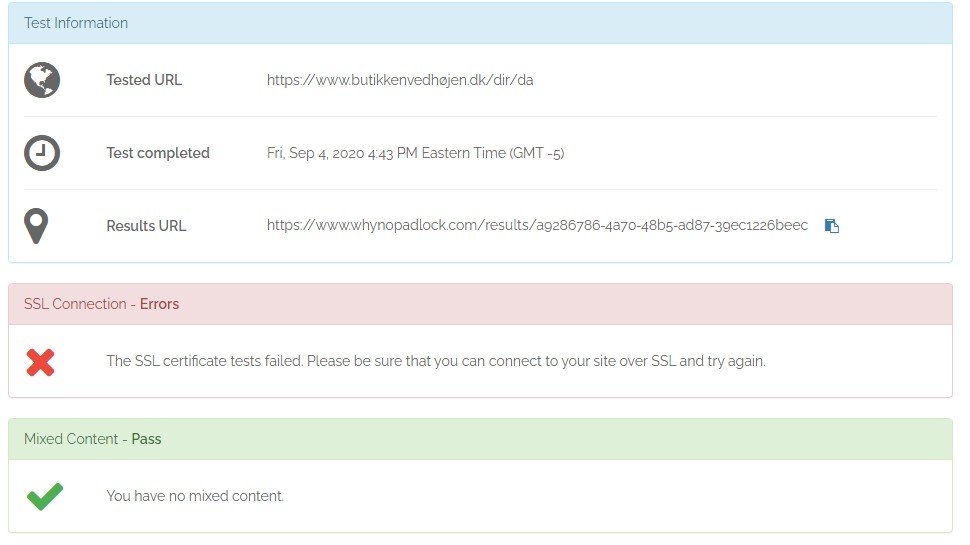

John Overby Posted September 4, 2020 Share Posted September 4, 2020 Well so far I have located the last two links and corrected them. I am in doubt regarding the first link http://xn--butikkenvedhjen-hub.dk/dir/, which seems to be the link to the whole Prestashop. Could you please direct me to where I can find it. I have tested the site again. Thanks for you effort so far. Link to comment Share on other sites More sharing options...
John Overby Posted September 4, 2020 Share Posted September 4, 2020 Link to comment Share on other sites More sharing options...
SwissGroove Posted September 4, 2020 Share Posted September 4, 2020 Hi, it's related to your header logo: <a id="header_logo" href="http://xn--butikkenvedhjen-hub.dk/dir/" title="Butikken ved højen"> Link to comment Share on other sites More sharing options...
John Overby Posted September 5, 2020 Share Posted September 5, 2020 I finally found it and corrected it. THX. Unfortunately, TLS is still not compatible, and my site is still not secure. ? But thanks for the effort 😀 I did correct quite a few errors Link to comment Share on other sites More sharing options...
