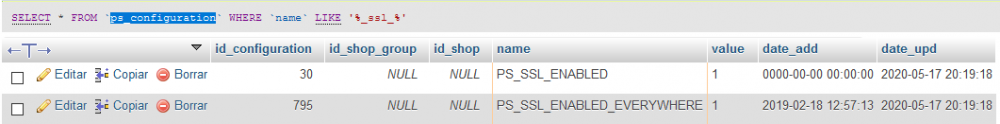

HETPE3B Posted January 7, 2021 Share Posted January 7, 2021 Just for a curiosity - is there any way to change this setting somewhere in the files on server, since my back office is not working (may be this is the reason my back office is not working as well as some part of the front office). Link to comment Share on other sites More sharing options...
amorrua Posted January 7, 2021 Share Posted January 7, 2021 (edited) @HETPE3B, try updating the field "value" from 0 to 1 of the rows which "name" fields are "PS_SSL_ENABLED" and "PS_SSL_ENABLED_EVERYWHERE" on the table named "ps_configuration" from the Prestashop database. Edited January 7, 2021 by amorrua (see edit history) Link to comment Share on other sites More sharing options...
HETPE3B Posted January 8, 2021 Share Posted January 8, 2021 Thank you. Found it, updated, but it didn't help. Link to comment Share on other sites More sharing options...
