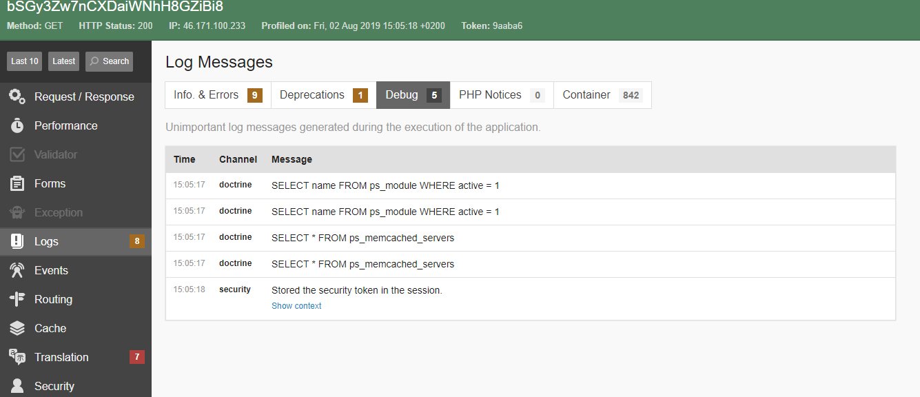

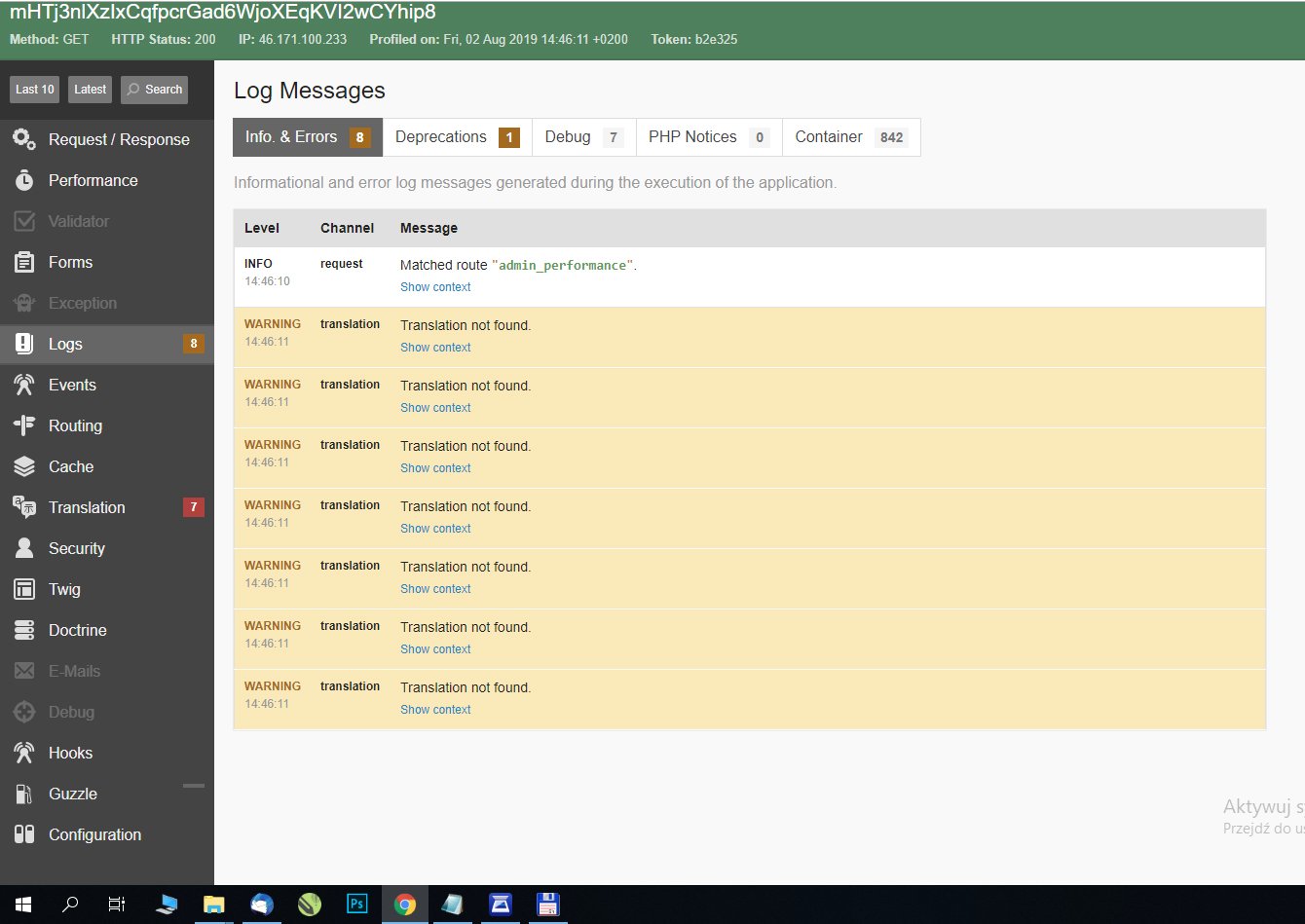

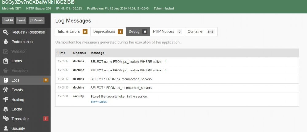

bakek Posted August 2, 2019 Author Share Posted August 2, 2019 Currently I don't have an access to error log file. I'm not sure If It's possible with my server provider. After logging in with debug mode on and going to log messages I've got something like this: Link to comment Share on other sites More sharing options...
prestamodulo Posted August 2, 2019 Share Posted August 2, 2019 It does not give any clue. can you check if there is something in debug tab ? If you are on shared hosting it may be on your website root folder. Link to comment Share on other sites More sharing options...
bakek Posted August 2, 2019 Author Share Posted August 2, 2019 10 minutes ago, prestamodulo said: If you are on shared hosting it may be on your website root folder. Do You have an idea what could be the name of the file? 11 minutes ago, prestamodulo said: It does not give any clue. can you check if there is something in debug tab ? Link to comment Share on other sites More sharing options...
