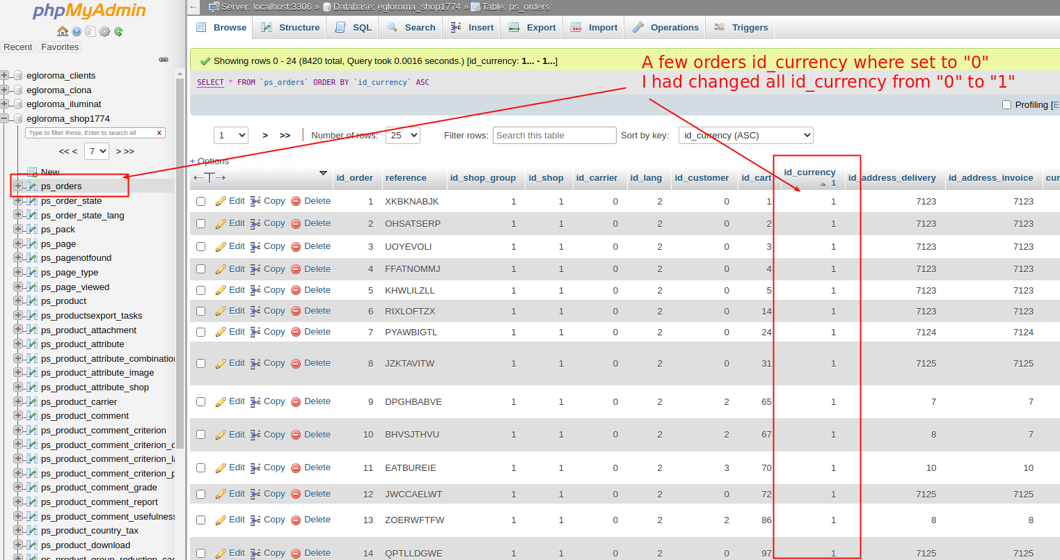

lordshop Posted January 11, 2021 Share Posted January 11, 2021 ok I found the solution. I was getting the error: Price specification not found for currency: "" [PrestaShop\PrestaShop\Core\Localization\Exception\LocalizationException 0] when I was trying to view the order page, after I reorder so the first would be the oldest. I find out that in column ID_currency there was several values 0, that didn't exist. I change the value to 1 (my default currency) and the problem solved. 3 Link to comment Share on other sites More sharing options...

rl_lucian Posted September 13, 2021 Share Posted September 13, 2021 On 1/11/2021 at 2:18 PM, lordshop said: ok I found the solution. I was getting the error: Price specification not found for currency: "" [PrestaShop\PrestaShop\Core\Localization\Exception\LocalizationException 0] when I was trying to view the order page, after I reorder so the first would be the oldest. I find out that in column ID_currency there was several values 0, that didn't exist. I change the value to 1 (my default currency) and the problem solved. Expand This solution worked for us also! Thanks @lordshop. In ps_order table, id_curency column, there was some values set to "0". We changed those values from "0" to "1" because these is shop default curency ID, and the problem was solved: https://ibb.co/qyV4Rzn 2 Link to comment Share on other sites More sharing options...

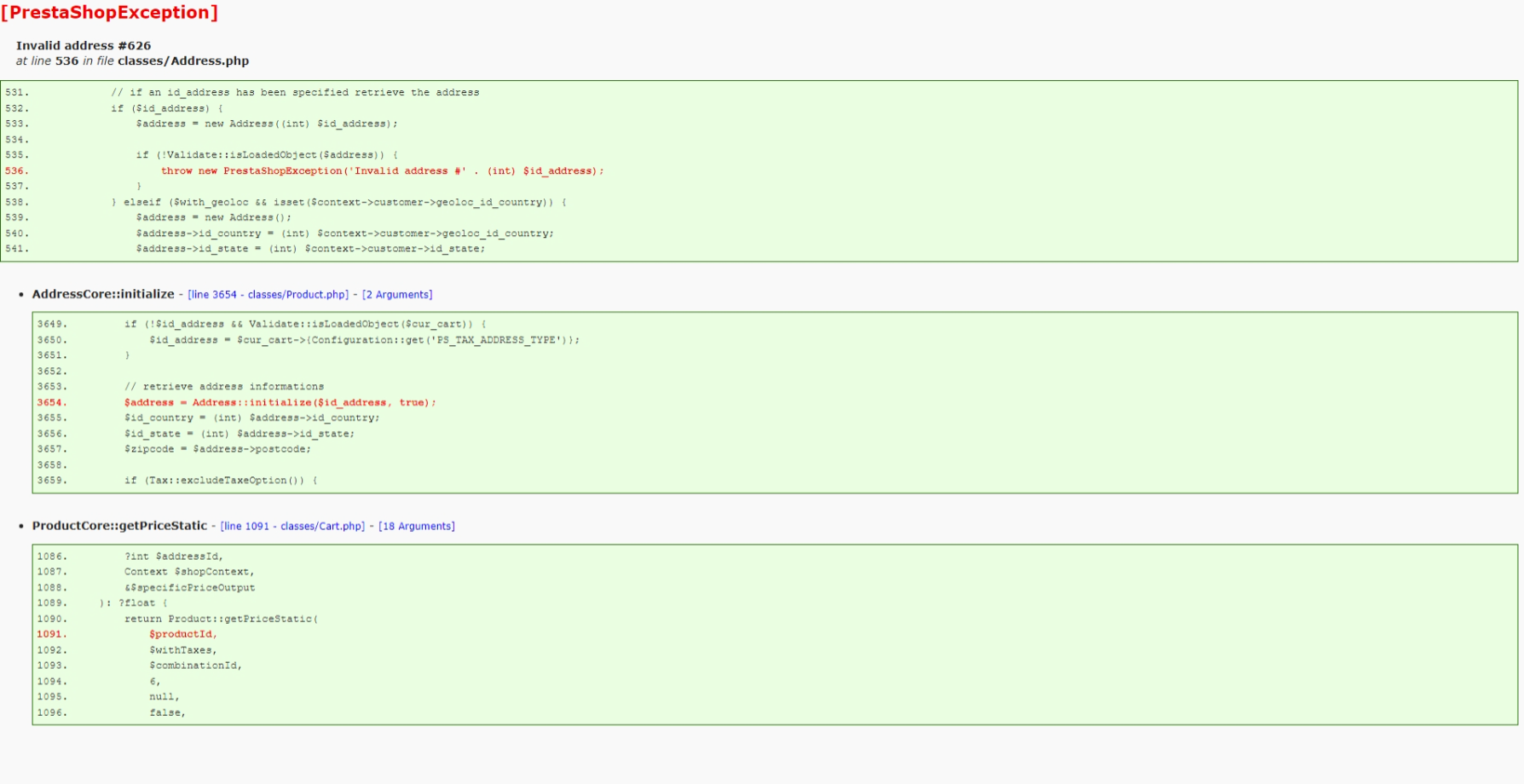

mostafamoaz Posted July 21, 2022 Share Posted July 21, 2022 i have same problem but not with id currency with id address any help please ? Link to comment Share on other sites More sharing options...
Prestachamps Posted July 21, 2022 Share Posted July 21, 2022 Hi, It seems that you have a bugged cart wich has an address assigned Id_address 626, and that address is not existing on the database. Here you can either recreate that address in the database or delete the cart with address 626. Hope I could help, Have a nice day, Leo. Link to comment Share on other sites More sharing options...
