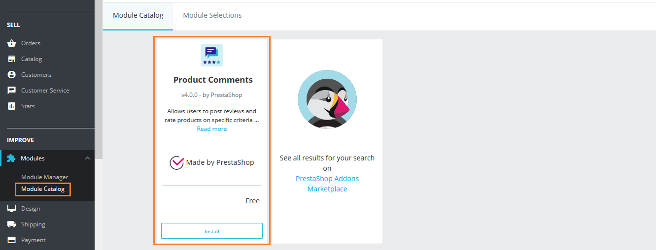

I upgraded to 1.7.6, searched 'productcomments' in modules catalog, found v4.0, clicked install and got
'Error! Exception thrown by module productcomments on install. Error sent by Addons. You may need to be logged.'

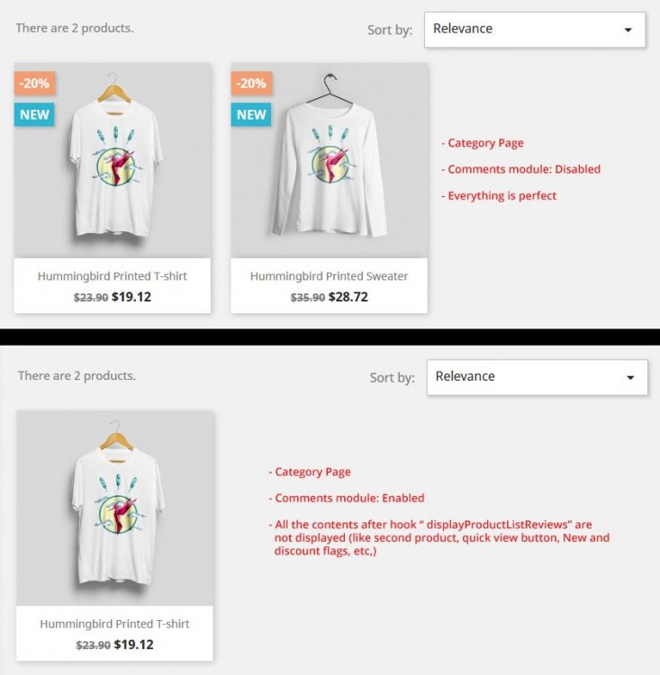

I have successfully installed this module (v4.0.0) on PS 1.7.6.0 (fresh installation) but facing a problem in front-office.
On category page, all the contents are not displayed after hook "displayProductListReviews". Check attached screenshot.
Same problem happens on product page too. The contents are not displayed after hook "displayProductAdditionalInfo".
The module is hooked in both those hooks which creates this problem.
I'm working on localhost.
I checked the module's TPL and JS files but couldn't find the solution and even the browser console isn't showing any errors.
Edit: I tried editing "productcomments.php" file and the contents are displayed after removing lines 941 to 943 (code below).
Of course, the smarty variables are empty in "product-list-reviews.tpl" file since we removed its required code but just want to inform that these 3 lines are causing this problem.
public function hookDisplayProductListReviews($params)
	/* Lines 941 to 943 */
        $productCommentRepository = $this->context->controller->getContainer()->get('product_comment_repository');
        $commentsNb = $productCommentRepository->getCommentsNumber($product->getId(), Configuration::get('PRODUCT_COMMENTS_MODERATE'));
        $averageGrade = $productCommentRepository->getAverageGrade($product->getId(), Configuration::get('PRODUCT_COMMENTS_MODERATE'));
Edited by roo10 (see edit history)

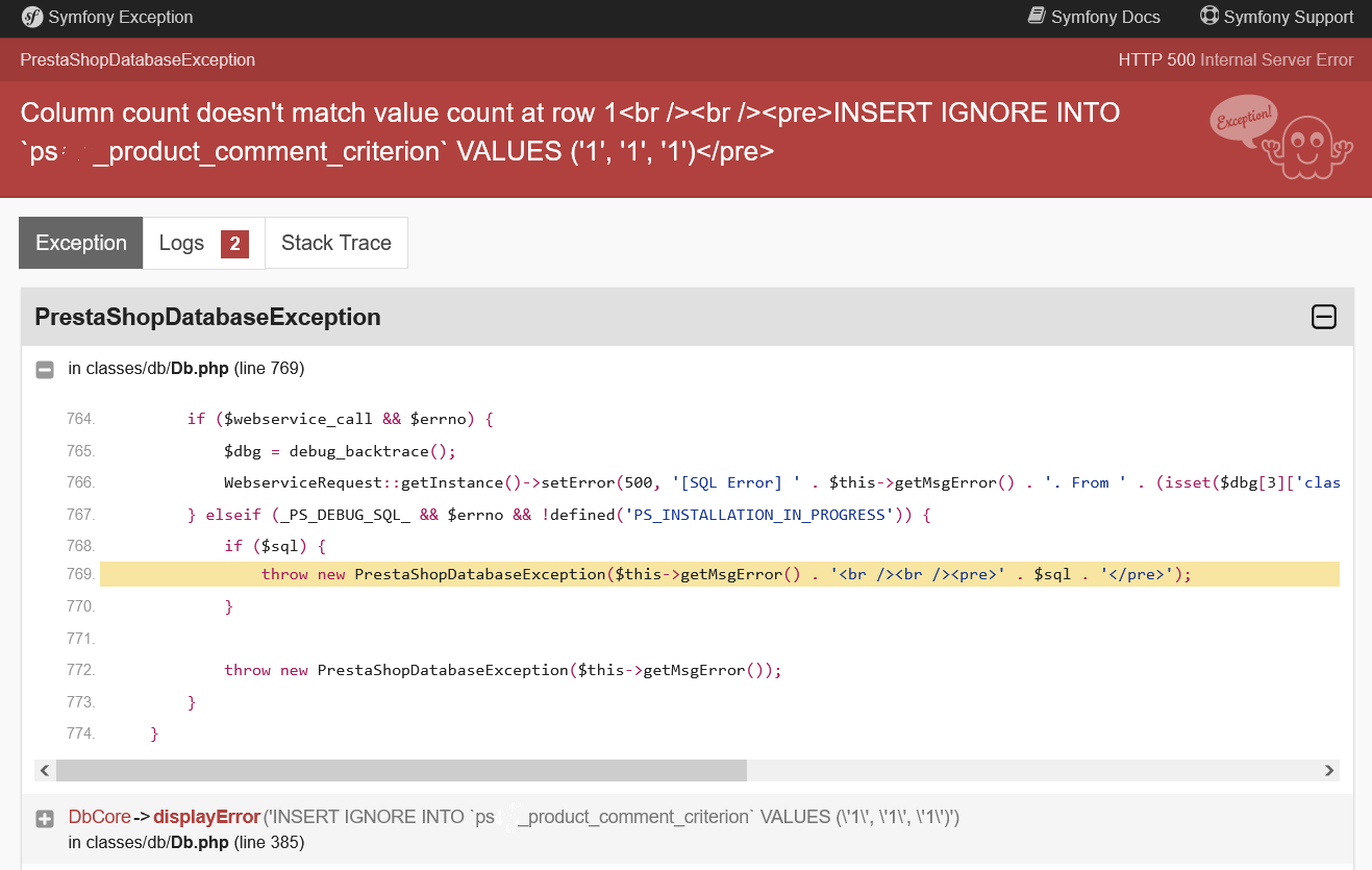

@templatin
the error that I had after activating the debug was:
"Column count doesn't match value count at row 1<br /><br /><pre>INSERT IGNORE INTO `ps_product_comment_criterion` VALUES ('1', '1', '1')</pre>"
I had uninstalled the module but the tables remained and I checked and saw the table "ps_product_comment_criterion", I removed it and then
Download it from here and you can install it by renaming it to
https://github.com/PrestaShop/productcomments/releases
the installation was OK and everything solved
