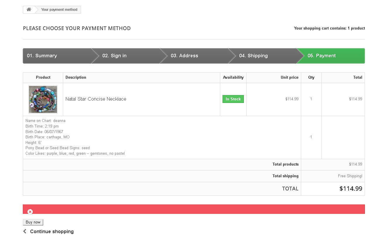

deannab Posted July 14, 2019 Author Share Posted July 14, 2019 the module is installed and enabled. the keys are added. running in stripe test mode. never make it to entering card details. there is an error (red alert box), but nothing to tell me what the problem is. Link to comment Share on other sites More sharing options...

deannab Posted July 14, 2019 Author Share Posted July 14, 2019 this is what i find in the error log on cpanel file manager [14-Jul-2019 17:46:43 US/Eastern] The payment method type provided: bancontact is invalid. See https://stripe.com/docs/api/payment_intents/create#create_payment_intent-payment_method_types for the full list of supported payment method types. went through everything on chat with support from stripe yesterday, and bancontact is not enabled anywhere. we don't know where it's coming from. Link to comment Share on other sites More sharing options...
