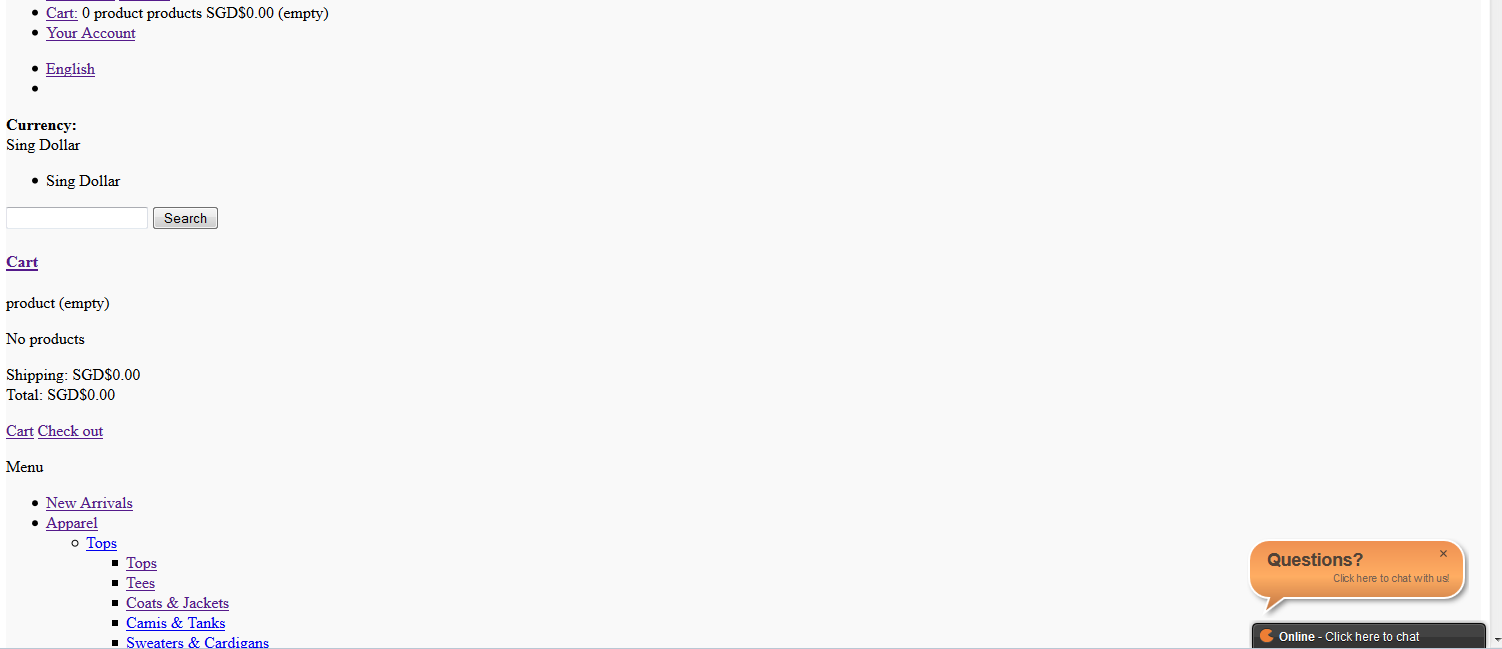

Hi Ralph
I had also done the same way, but my website came out in a total mess. I have attached the picture.
Edited by cutecat (see edit history)

  On 8/24/2013 at 7:11 PM, cutecat said:
Hi Ralph
Hey Cutecat!
Did you manage to do it in the end? I got the same outcome as you but when i did a wildcard redirect from the subdomain to the shop domain the layout returned to normal. You can see through the network tab in the browser that the servers are being used, but there doesn't seem to be any change in page load though.
Edited by Cari (see edit history)
