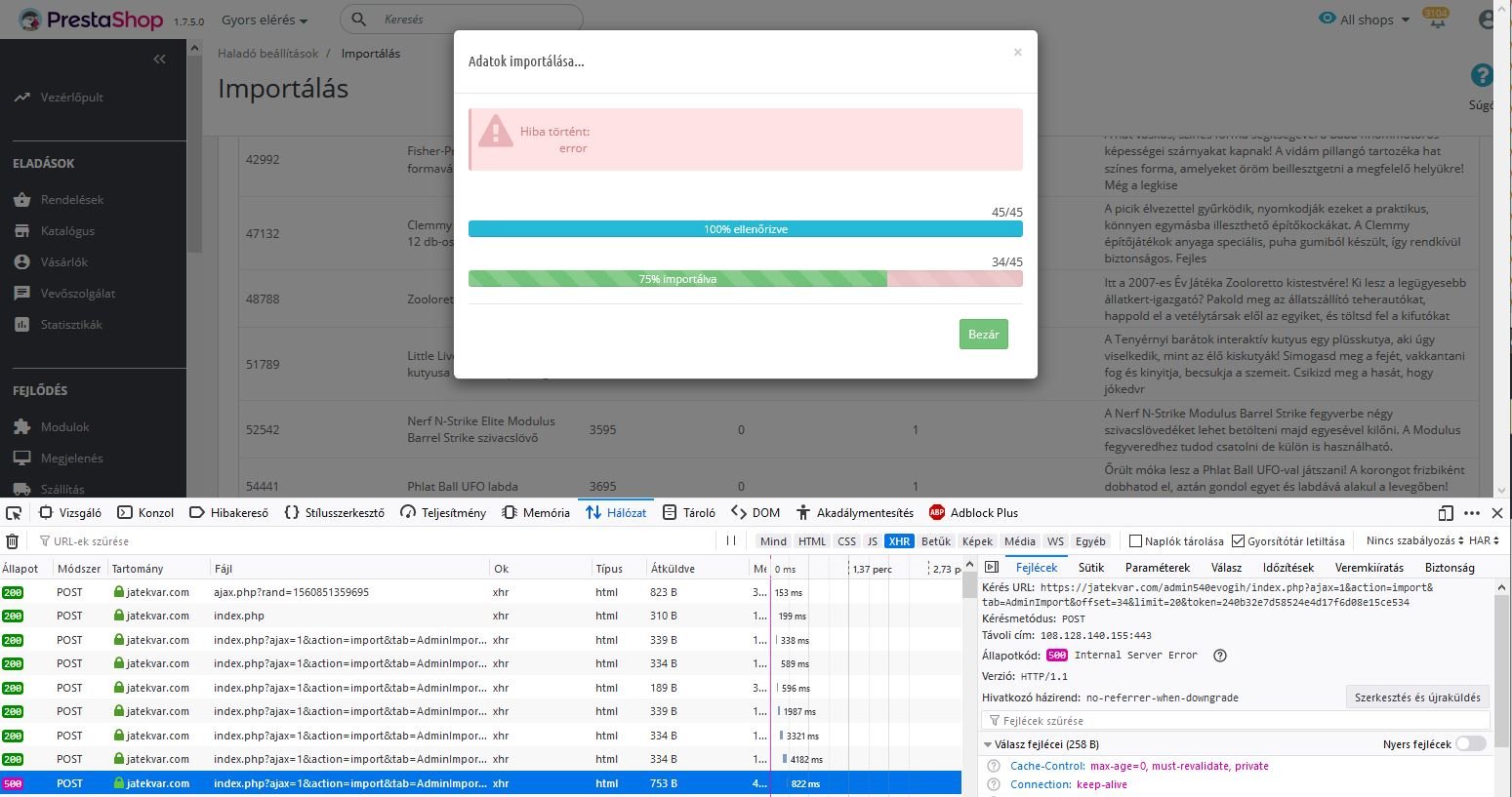

I'm getting totally confused because I can't find a solution for long days for my issue already.
What we have: A working PS 1.7.5 production MULTISHOP site with 2 shops, VPS (Apache/Nginx, PHP 7.2) and Transformer theme by S-T themes.
The items are updated daily and we can't determine the start of this issue but it started to stop with the "error" message.
I figured out that there's an Internal server error 500 by the ajax call. Even if only 2-3 columns are imported! Please see the screenshot below.
Sometimes after 5 products, sometimes 15, absolutely random values.
The site owner told me that sometimes he managed to finish it for 3rd-4th try, sometimes totally not.
The CSV files seem to be perfect.
I had a developement version of the site and I couldn't reproduce the issue. (I hardly believed the owner that the issue presists.)
The biggest comedy that I cloned the site on the server to figure out what the problem was and after several tries surprisingly it started to work. They are in the same environment and I'm not able to mess it up again -> so I don't know the solution.

Hi.
I'm trying to revive this topic, because this problem is very random and I was having the same error on many different versions of Prestashop (starting with 1.6.1, now on 1.7.7.3). Different servers, different settings, different templates, the same error.
Maybe there's a way to see details of this error?
Other errors at least give you some info on it (like "length os name is too big", "tags field too long" or "unacceptable symbols" and shows you the ID of the product with the problem, so you can figure out the issue... but this "error" is just an "error" and gives you nothing more... is it logged anywhere?
