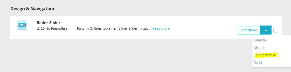

JBW Posted June 11, 2019 Share Posted June 11, 2019 Seems the slider is not actived for mobile by default (I assume to save bandwidth on slow mobile connections) - you can activate it directly in the module manager: 1 1 Link to comment Share on other sites More sharing options...
