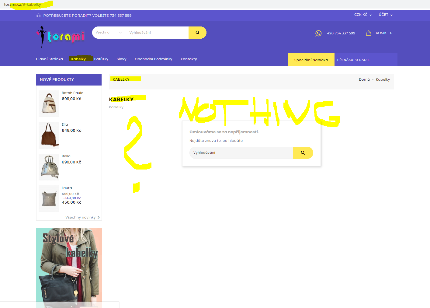

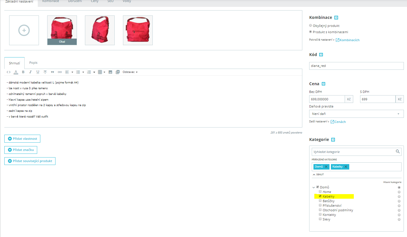

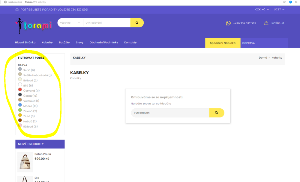

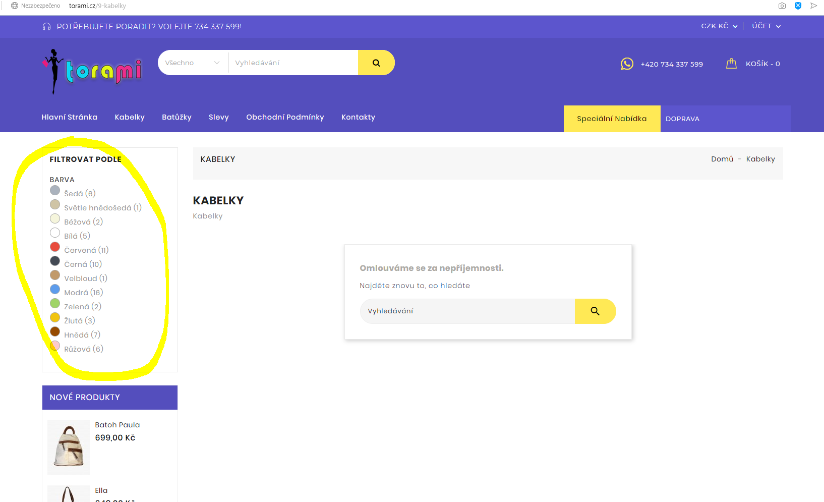

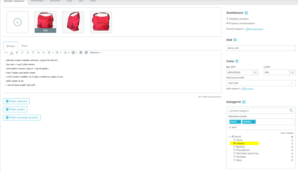

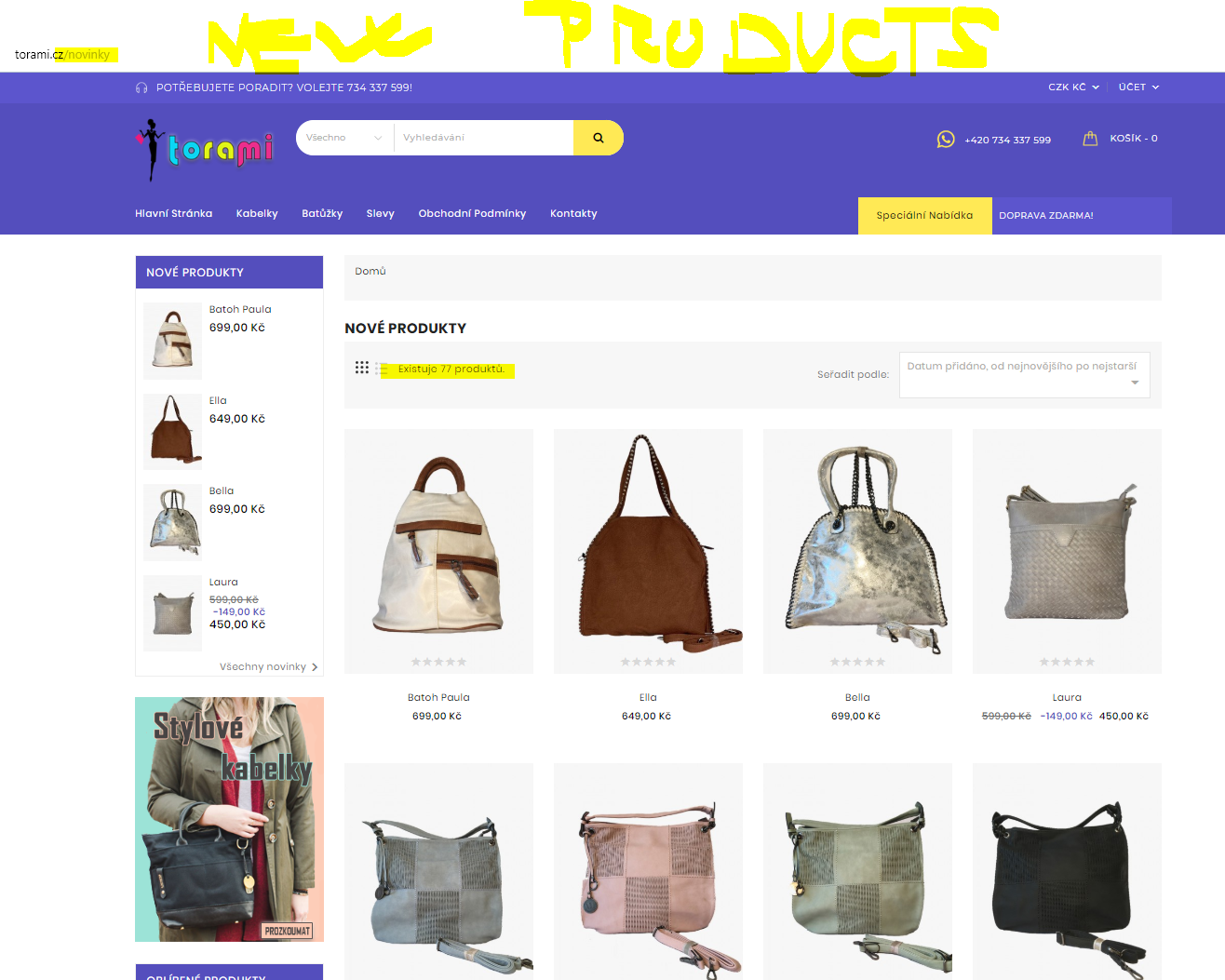

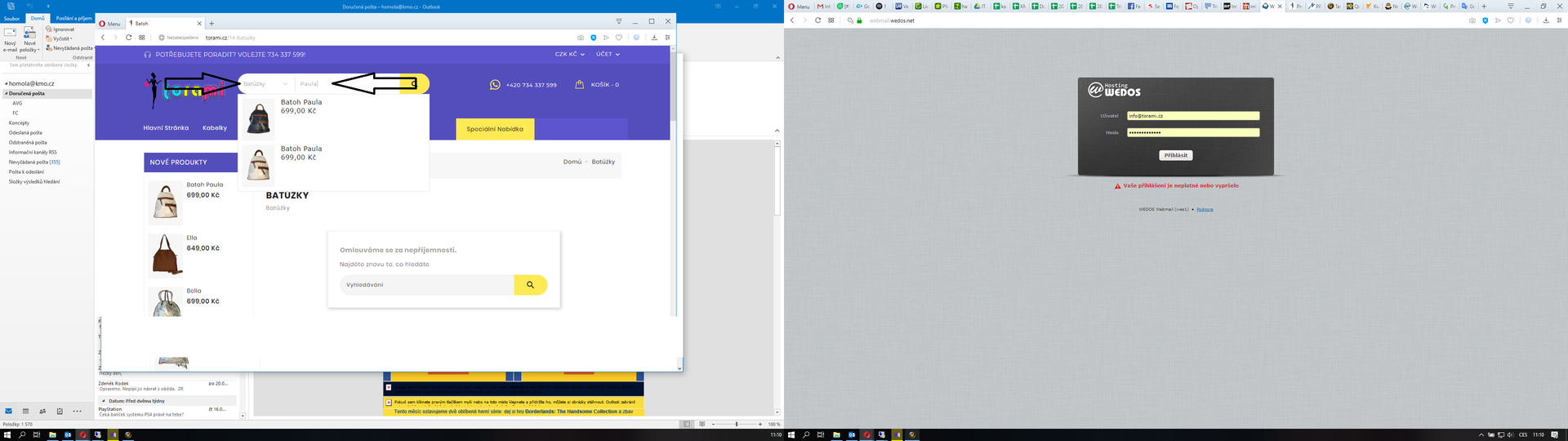

torami Posted June 3, 2019 Share Posted June 3, 2019 Hi, I have a problem with products in categories. More precisely, I didn't have a problem. I have created categories where I have included products (everything worked), but now I edited the prices (canceling VAT on prices) and the products disappeared from the categories. Respectively, the products as such are probably there because I see a filter by color with the number in that color, but the content itself is not there. (See pic.). I have tried to create a whole new category, but when I add a product to a new category, it is not showing. I tried to create a brand new product and put it in a whole new category but unfortunately with the same result. It should be noted that when I select the category I want to search for in the search box (for example: Handbags) and write the name of the handbag (eg: Leona) I will find the handbag in the category ... from which I decided that the handbags there they are, but they just don't show up for some mysterious reason. My visibility is set to everywhere. Everything else I think set as it did (except VAT) - Yes, I tried to return the VAT (no success). The only place where my handbags are displayed is news (this page is predefined by the page manufacturer and is not configurable). web: www.torami.cz because of the fact that the shop is already in operation, I had to remove the incriminated category from the visible so here is the link: www.torami.cz/9-kabelky a www.torami.cz/14-batuzky I'm sending some images for clarification. I will be glad for any ideas, opinions, suggestions ... I am quite desperate, thank you very much Link to comment Share on other sites More sharing options...
Janett Posted June 3, 2019 Share Posted June 3, 2019 Did you make update of module Faceted Search (ps_facetedsearch) ? Take a look in https://github.com/PrestaShop/PrestaShop/issues?utf8=✓&q=is%3Aissue+label%3A"Faceted+search" Link to comment Share on other sites More sharing options...
