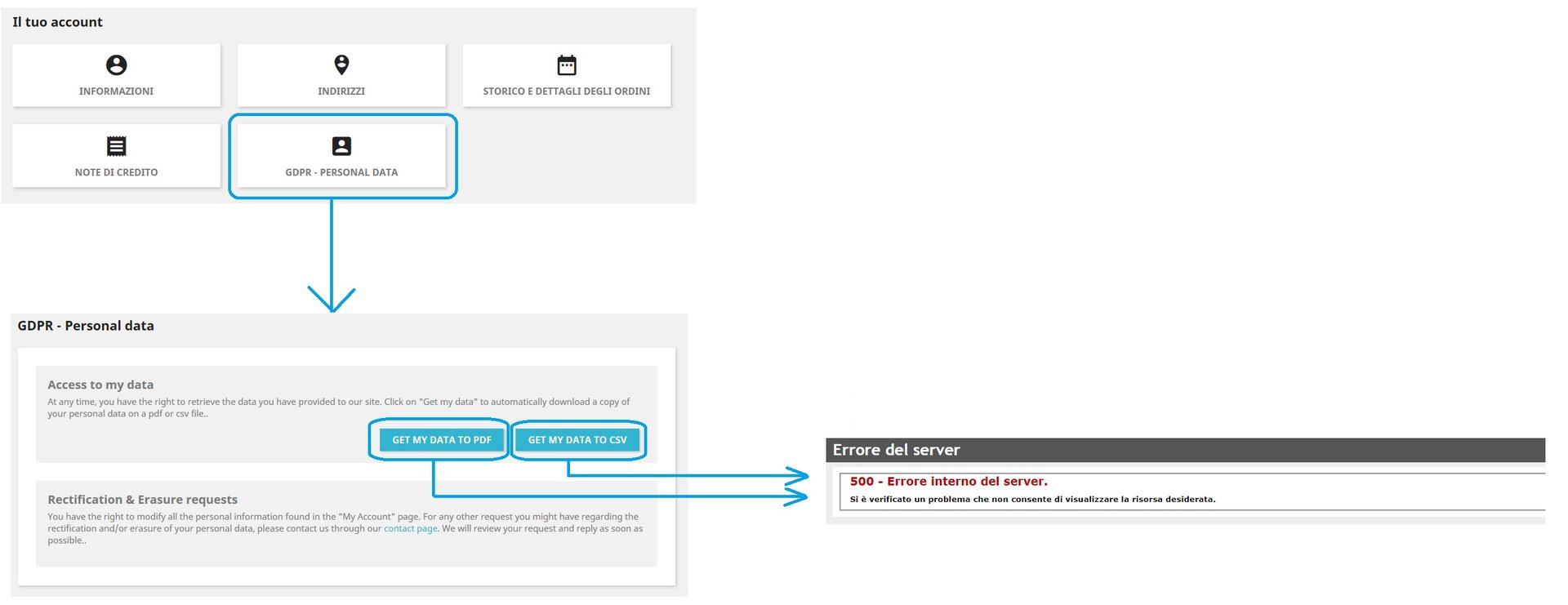

Gigi76 Posted May 31, 2019 Share Posted May 31, 2019 Hi everyone, I have this configuration: - Windows Server 2019 con IIS 10 - Prestashop 1.7.5.1 - MySql 5.6.16.0 - PhpMyAdmin 4.8.5 - PHP 7.2.16 I installed the Official GDPR v1.1.3 Conformity Module of PrestaShop but I get an error if I try to export personal data from the customer profile management page, both in csv and in pdf. 500 - Internal Server Error There is a problem that does not allow you to view the desired resource Also is it possible to insert the text in another language (for me Italian) instead of this in English? Access to my data At any time, you have the right to retrieve the data you have provided to our site. Click on "Get my data" to automatically download a copy of your personal data on a pdf or csv file.. Rectification & Erasure requests You have the right to modify all the personal information found in the "My Account" page. For any other request you might have regarding the rectification and/or erasure of your personal data, please contact us through our contact page. We will review your request and reply as soon as possible.. Has anyone already had experience of this? Thank you in advance! Link to comment Share on other sites More sharing options...

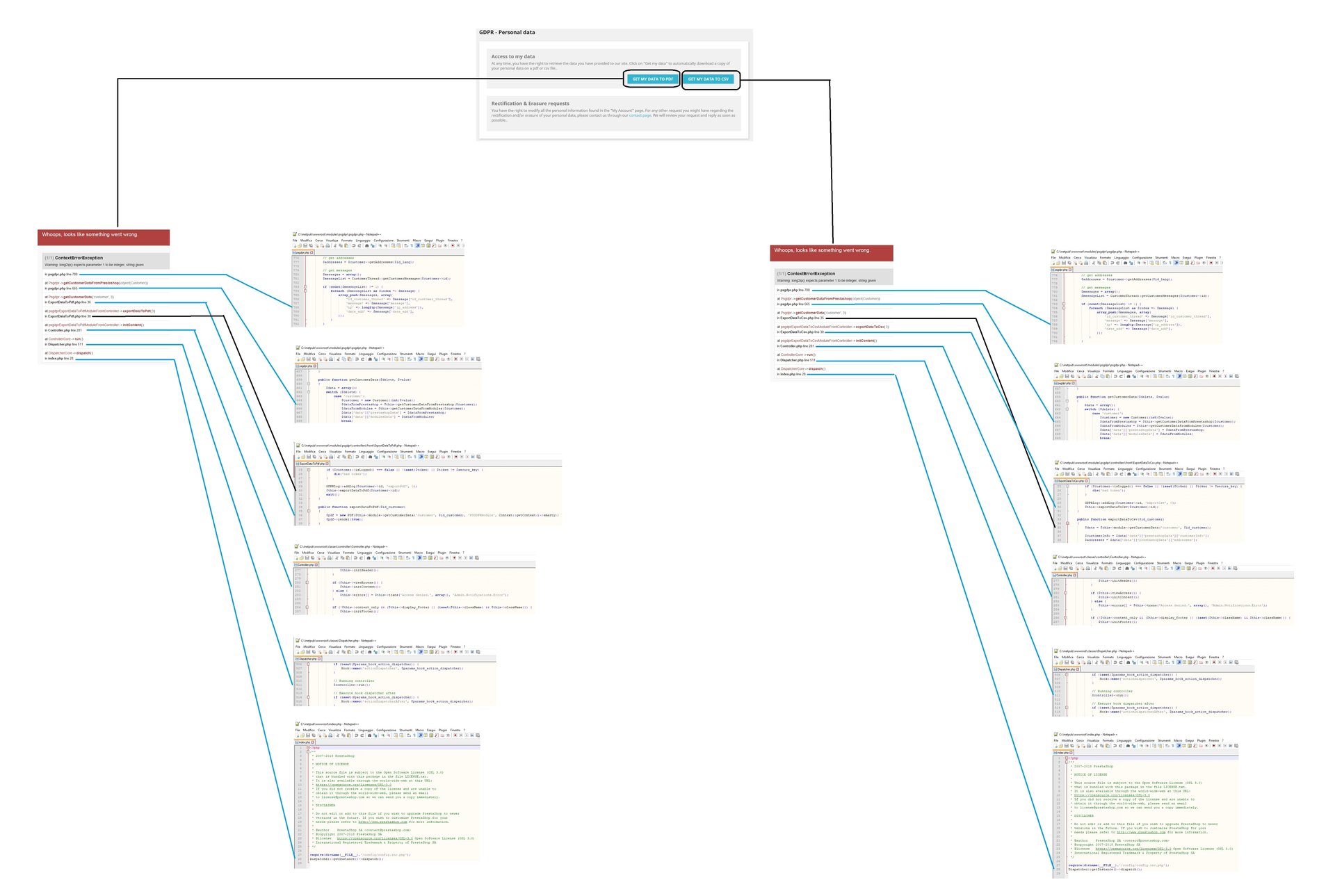

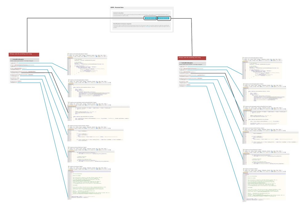

Gigi76 Posted May 31, 2019 Author Share Posted May 31, 2019 2 ore fa, NemoPS dice: Enable dev mode from the back office, advanced parameters, and see if you get anything more descriptive Hi NemoPS, if I enable debug mode, the error that occurs is as follows: IF I CLICK “GET MY DATA TO PDF” (1/1) ContextErrorException Warning: long2ip() expects parameter 1 to be integer, string given in psgdpr.php line 788 at Psgdpr->getCustomerDataFromPrestashop(object(Customer)) in psgdpr.php line 665 at Psgdpr->getCustomerData('customer', 3) in ExportDataToPdf.php line 36 at psgdprExportDataToPdfModuleFrontController->exportDataToPdf(3) in ExportDataToPdf.php line 30 at psgdprExportDataToPdfModuleFrontController->initContent() in Controller.php line 281 at ControllerCore->run() in Dispatcher.php line 511 at DispatcherCore->dispatch() in index.php line 28 if I go to open the individual files .php here are the lines indicated: in psgdpr.php line 788 'ip' => long2ip($message['ip_address']), in psgdpr.php line 665 $dataFromPrestashop = $this->getCustomerDataFromPrestashop($customer); in ExportDataToPdf.php line 36 $pdf = new PDF($this->module->getCustomerData('customer', $id_customer), 'PSGDPRModule', Context::getContext()->smarty); in ExportDataToPdf.php line 30 $this->exportDataToPdf($customer->id); in Controller.php line 281 $this->initContent(); in Dispatcher.php line 511 $controller->run(); in index.php line 28 Dispatcher::getInstance()->dispatch(); IF I CLICK “GET MY DATA TO CVS” (1/1) ContextErrorException Warning: long2ip() expects parameter 1 to be integer, string given in psgdpr.php line 788 at Psgdpr->getCustomerDataFromPrestashop(object(Customer)) in psgdpr.php line 665 at Psgdpr->getCustomerData('customer', 3) in ExportDataToCsv.php line 35 at psgdprExportDataToCsvModuleFrontController->exportDataToCsv(3) in ExportDataToCsv.php line 30 at psgdprExportDataToCsvModuleFrontController->initContent() in Controller.php line 281 at ControllerCore->run() in Dispatcher.php line 511 at DispatcherCore->dispatch() in index.php line 28 if I go to open the individual files .php here are the lines indicated: in psgdpr.php line 788 'ip' => long2ip($message['ip_address']), in psgdpr.php line 665 $dataFromPrestashop = $this->getCustomerDataFromPrestashop($customer); in ExportDataToPdf.php line 35 $data = $this->module->getCustomerData('customer', $id_customer); in ExportDataToPdf.php line 30 $this->exportDataToPdf($customer->id); in Controller.php line 281 $this->initContent(); in Dispatcher.php line 511 $controller->run(); in index.php line 28 Dispatcher::getInstance()->dispatch(); Thank you in advance! Link to comment Share on other sites More sharing options...
