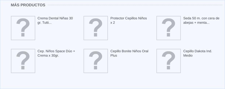

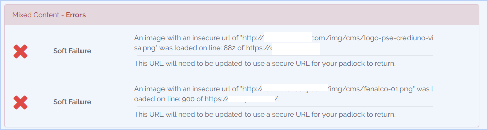

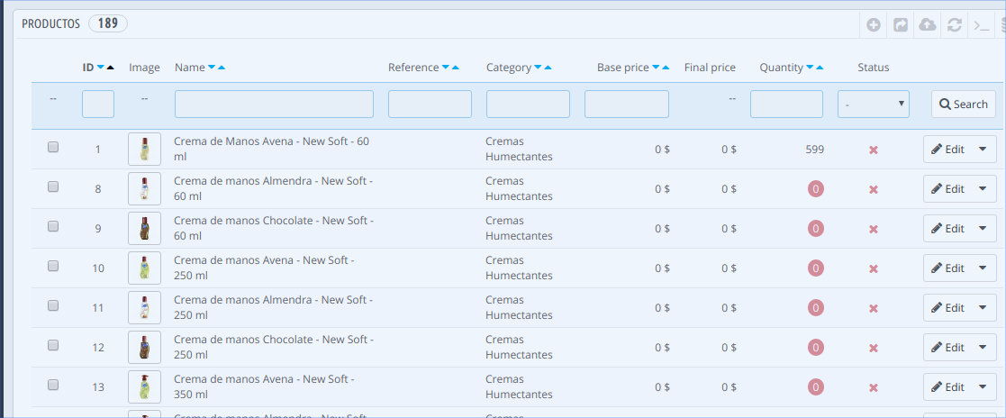

killmasta93 Posted May 17, 2019 Share Posted May 17, 2019 Hi, I was wondering if someone could shed some light on the issue im having. Currently migrated my prestashop from a shared hosting to my server, as i also changed the domain. everything came up fine just 2 issues. 1) i have some mixed content i found only 2 links which have mixed content, check with the whynopadlock and found 2 links which seems to be using the olddomain not sure why 2) on the home page does not show the products which is odd because i go to the admin panel and see the products there. see pictures Thank you Link to comment Share on other sites More sharing options...

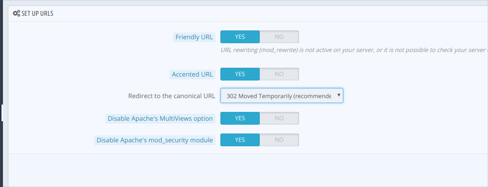

NemoPS Posted May 18, 2019 Share Posted May 18, 2019 For the padlock images, they are hardcoded in the cms it seems. For the others, are you using url rewriting? Try clearing your cache and disabling/enabling clean urls. Link to comment Share on other sites More sharing options...
killmasta93 Posted May 18, 2019 Author Share Posted May 18, 2019 Thanks for the reply, as for the url rewriting i think i do have it i clean cache on prestashop and on the browswer then i checked chrome using f12 and saw the 404 Failed to load resource: the server responded with a status of 404 (Not Found) and as for the hardcodded in the cms how could i fix this only 2 things are affected which is causing the mixed content Thank you Link to comment Share on other sites More sharing options...
NemoPS Posted May 19, 2019 Share Posted May 19, 2019 For the cms, you have to reach each cms page and just change the url to https Link to comment Share on other sites More sharing options...
killmasta93 Posted May 19, 2019 Author Share Posted May 19, 2019 Thanks for the reply, would i access the phpmyadmin thought the database and find the URL? if so where would it be in the database? Link to comment Share on other sites More sharing options...
NemoPS Posted May 20, 2019 Share Posted May 20, 2019 No, in the back office, preferences, cms Link to comment Share on other sites More sharing options...
