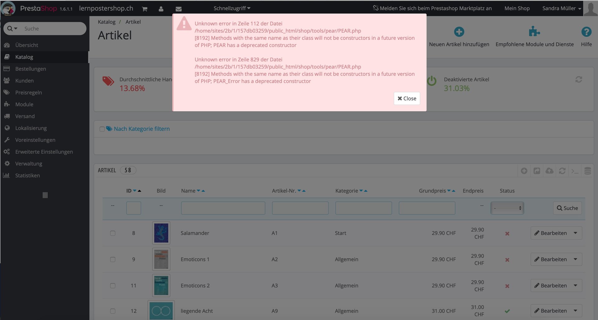

Sandra Moyo Posted May 17, 2019 Author Share Posted May 17, 2019 So, error reporting ist aktiviert 🙂 bei der weissen Seite für den Wartungsmodus zu aktivieren kommt : Fatal error: Uncaught Error: Access to undeclared static property: Validate::$field in /home/sites/2b/1/157db03259/public_html/shop/classes/controller/AdminController.php:3640 Stack trace: #0 /home/sites/2b/1/157db03259/public_html/shop/classes/controller/AdminController.php(1425): AdminControllerCore->validateField(0, Array) #1 /home/sites/2b/1/157db03259/public_html/shop/classes/controller/AdminController.php(897): AdminControllerCore->processUpdateOptions() #2 /home/sites/2b/1/157db03259/public_html/shop/classes/controller/Controller.php(178): AdminControllerCore->postProcess() #3 /home/sites/2b/1/157db03259/public_html/shop/classes/Dispatcher.php(367): ControllerCore->run() #4 /home/sites/2b/1/157db03259/public_html/shop/admin1137/index.php(58): DispatcherCore->dispatch() #5 {main} thrown in /home/sites/2b/1/157db03259/public_html/shop/classes/controller/AdminController.php on line 3640 Beim Fehler direkt wenn ich mich einlogge ist der Fehler der im Screenshot kommt. Beim Fehler der Gastbestellung kommt folgendes: Fatal error: Uncaught Error: Access to undeclared static property: Validate::$data in /home/sites/2b/1/157db03259/public_html/shop/classes/ObjectModel.php:1149 Stack trace: #0 /home/sites/2b/1/157db03259/public_html/shop/controllers/front/AuthController.php(430): ObjectModelCore->validateController() #1 /home/sites/2b/1/157db03259/public_html/shop/controllers/front/AuthController.php(256): AuthControllerCore->processSubmitAccount() #2 /home/sites/2b/1/157db03259/public_html/shop/classes/controller/Controller.php(178): AuthControllerCore->postProcess() #3 /home/sites/2b/1/157db03259/public_html/shop/classes/Dispatcher.php(367): ControllerCore->run() #4 /home/sites/2b/1/157db03259/public_html/shop/index.php(28): DispatcherCore->dispatch() #5 {main} thrown in /home/sites/2b/1/157db03259/public_html/shop/classes/ObjectModel.php on line 1149 Liebe Grüsse und Danke Link to comment Share on other sites More sharing options...
Sandra Moyo Posted May 17, 2019 Author Share Posted May 17, 2019 Whiley, kann es sein das es an der PHP Version liegt? hab von 5.6 auf 7.0 gewechselt, weil ich nebenbei auf dem Hosting den Prestashop auf 1.7 aufbauen wollte. Hab nun zurückgewechselt und die Bestellung geht. ganz schreg. Link to comment Share on other sites More sharing options...
Whiley Posted May 17, 2019 Share Posted May 17, 2019 PHP 7.0 ist veraltet und hat Fehler, wenn dann PHP 7.1 oder 7.2 installieren, damit ein PS 1.6 unter PHP 7.2 läuft sind Anpassungen erforderlich aso besser bei 5.6 bleiben Grüsse Whiley Link to comment Share on other sites More sharing options...
Sandra Moyo Posted May 17, 2019 Author Share Posted May 17, 2019 ok danke für die info, dann bleib ich bei 5.6 bin so froh hab ich denn fehler gefunden🙄 die 1.7 läuft aber nur mit php 1.7 oder? ich hab immer noch tonnenweise spam, trotz neuer mail addy und eicaptcha. 🙄 Link to comment Share on other sites More sharing options...

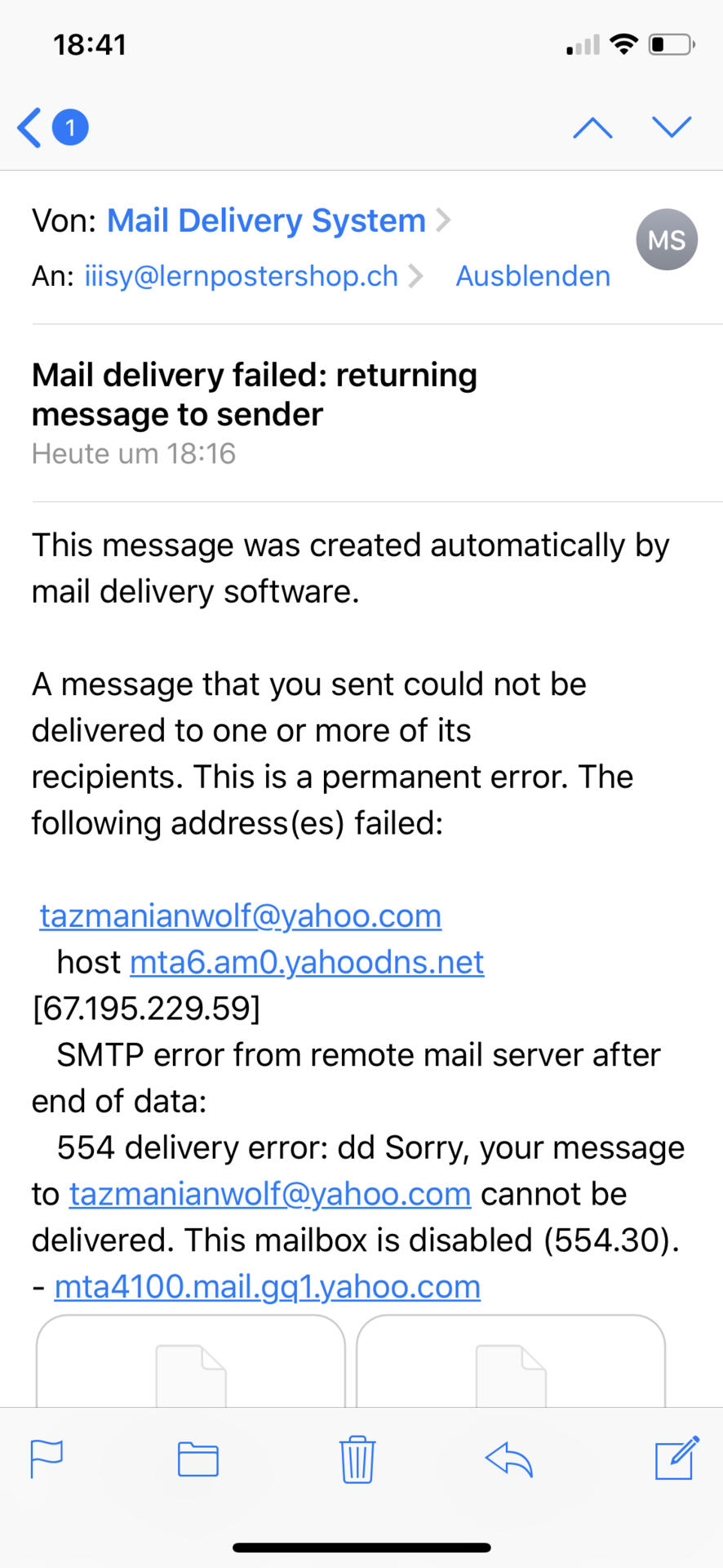

rictools Posted May 17, 2019 Share Posted May 17, 2019 Das sieht so aus, als ob deine E-Mail-Adresse nicht aktiv ist, das hat nichts mit Prestashop zu tun. Was den Spam angeht, kommt der denn über das Kontaktformular von Prestashop? Oder wird der halt einfach normal an deine E-Mail-Adresse(n) geschickt? Link to comment Share on other sites More sharing options...

Sandra Moyo Posted May 23, 2019 Author Share Posted May 23, 2019 Sory, meine verspätete Antwort. Also bei mir scheint es, dass die in meinem mail namen an deren mails versenden. Siehe Bild. Ich weiss echt nicht mehr was tun, hab mail geändert, captcha eingebaut, link zur kontaktseite geändert und nun ist alles wieder wie vorher....ohje mine. Link to comment Share on other sites More sharing options...

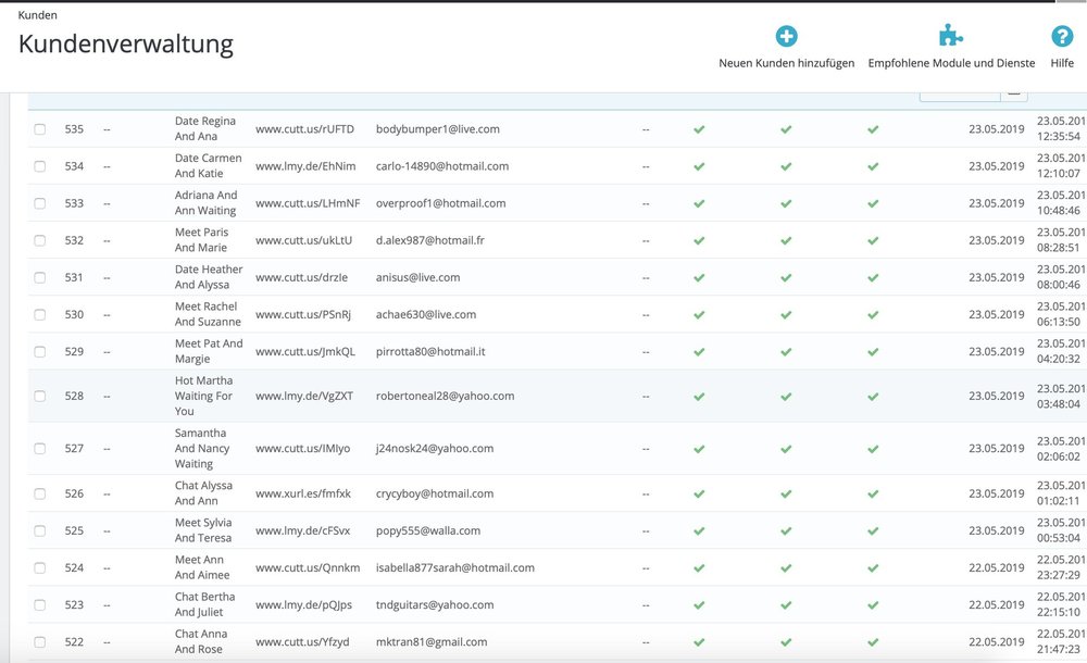

rictools Posted May 23, 2019 Share Posted May 23, 2019 (edited) Oh oh, wenn du Kontaktanfragen nicht von Kundenanmeldungen unterscheiden kannst solltest du dich erst einmal mit den Grundlagen von Prestashop beschäftigen (wobei dieser Unterschied eigentlich jedem Schulkind klar sein müßte unabhängig von Prestashop ...). Also zur Klarstellung, die melden sich als Kunden an, dabei wird dann automatisch eine Bestätigung der Anmeldung per E-Mail versandt, wobei dann die URL als Name da drin steht, d. h. der Kunde wird mit "Hallo Date Regina And Ana www.cut..." angesprochen, ich kann mir ja nicht vorstellen, daß den Spammern das viel bringt, aber vielleicht ruft dann der eine oder andere diese Domain auf. Edited May 23, 2019 by rictools (see edit history) Link to comment Share on other sites More sharing options...
Sandra Moyo Posted May 23, 2019 Author Share Posted May 23, 2019 oh oh 😊 ich kann das unterscheiden aber nicht im zusammenhang mit den mails, es kamen zweierlei- mit nachrichten über das Kontaktformular und die anmeldungen. dann kann ich da nix dagegen machen? Danke dir 😊 Link to comment Share on other sites More sharing options...
rictools Posted May 23, 2019 Share Posted May 23, 2019 Du hast einen Screenshot gezeigt und da sind eindeutig Spam-Kunden zu sehen und das wirst du mit Maßnahmen gegen Spam über das Kontaktformular nicht verhindern, ggf. handelt es sich hier um zwei Themen. Zum Theme Spam über Kundenanmeldungen gibt es bereits einen Thread. Link to comment Share on other sites More sharing options...
