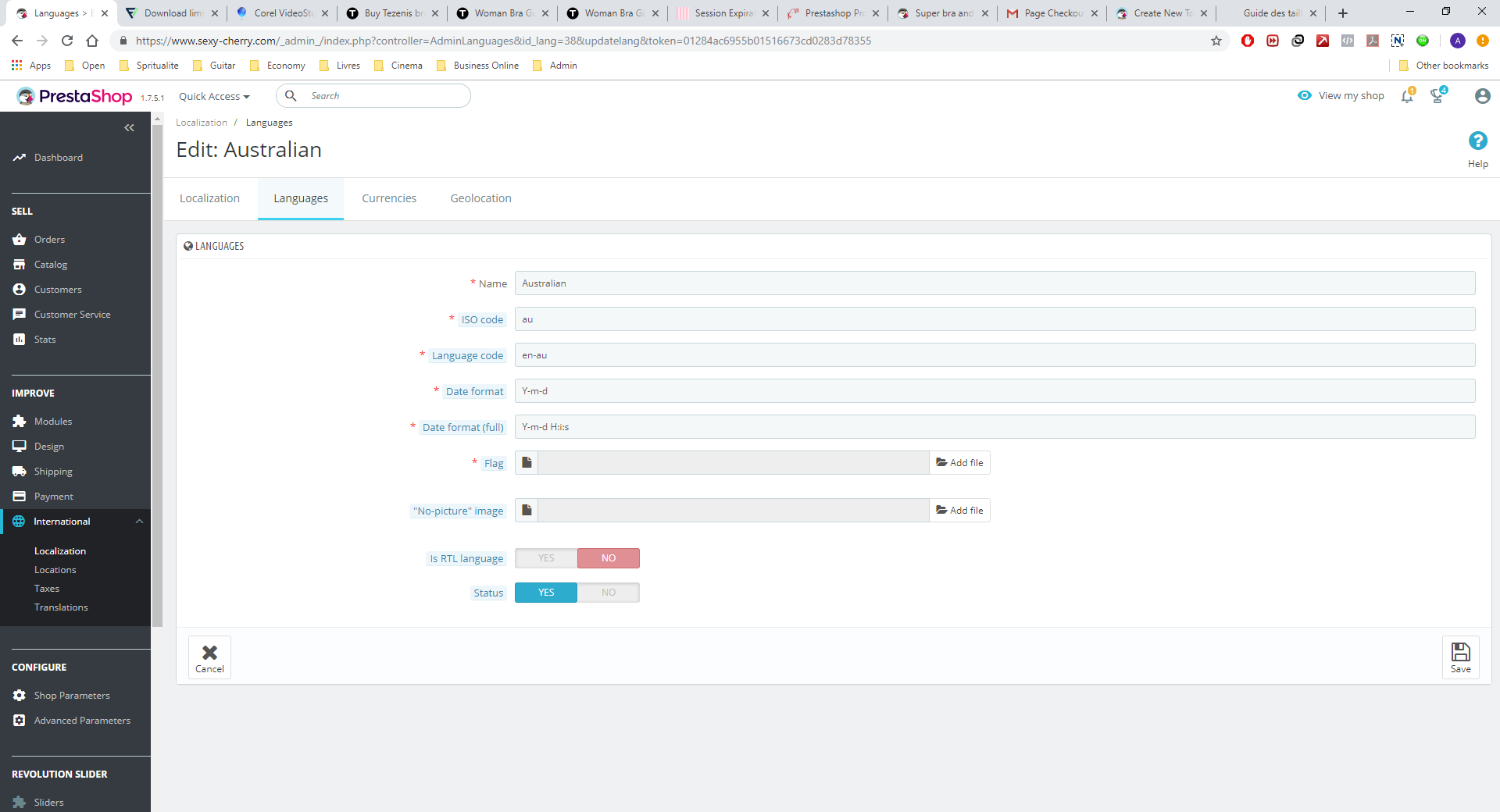

I'm on Prestashop 1.7, i've create the Australian language due to some specificities of this market (i'd likie to add somes specific size attributes for that region of the world), but i had to create it 'from scratch' cause there is no language pack, and i need the /au at the end of my URLs to make the stuff looking serious.
Some guys suggested me to import a language pack, but if i do so, the URLs will be, for example, /gb or watever, which dosn't really look pro, and i can't change it....
The problem is that languages created 'from scratch' aren't working well with the translation manager.
In fact, i cannot modify anything (modules, classic theme, custom theme) with this. Any idea ?

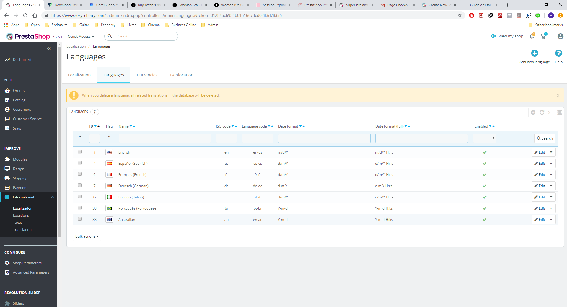

here i've created the language from scratch
here the 'Au' language

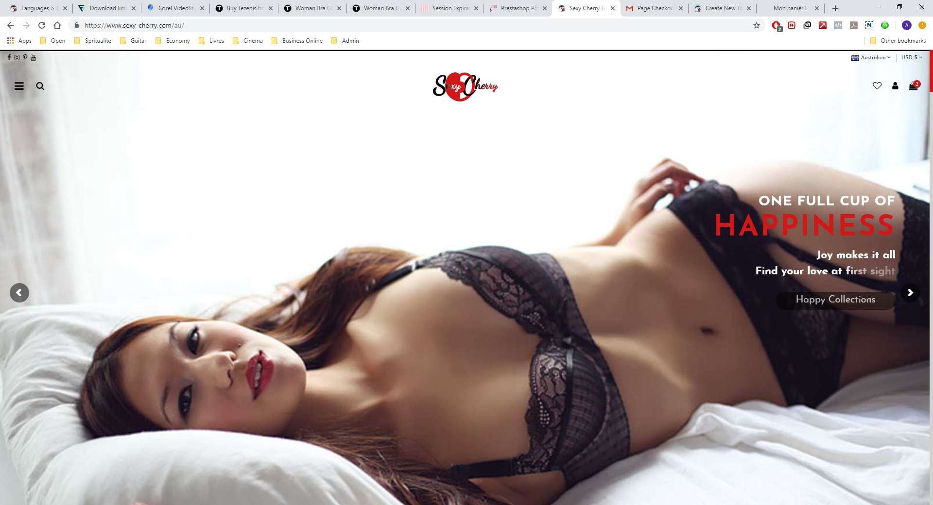

here the homepage with /au extension and nice cool little Australian flag

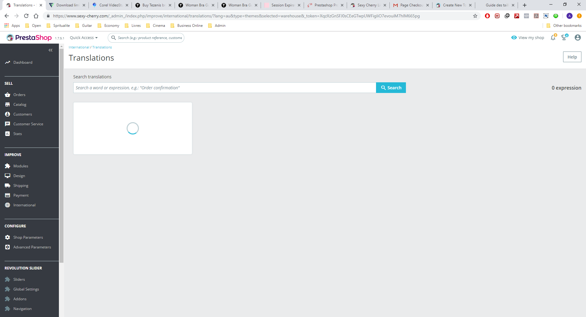

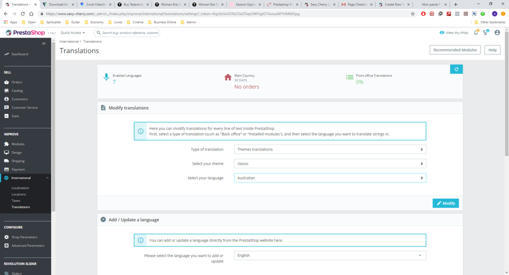

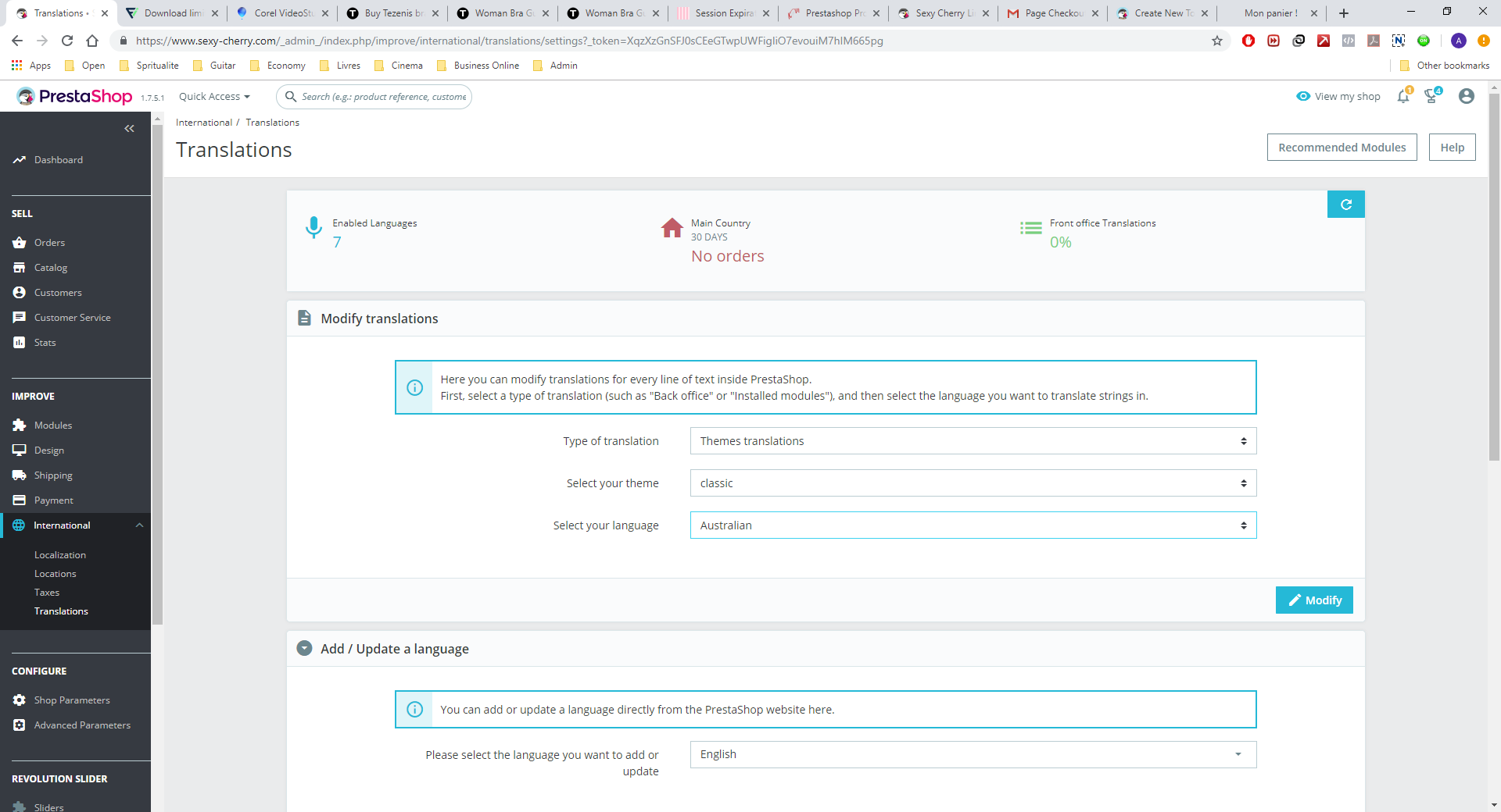

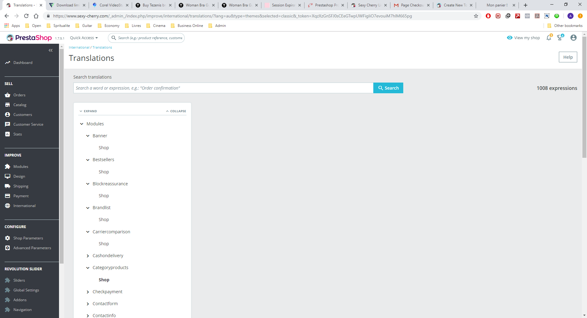

here the translations that cannot work >>>>
nothing appears on screen for theme translations / modules translations etc etc... or worst,  'internal server error'.......

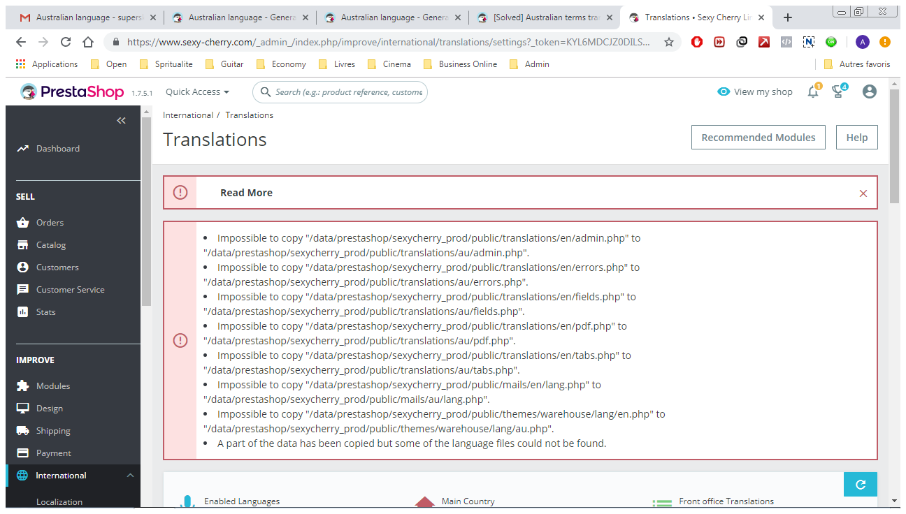

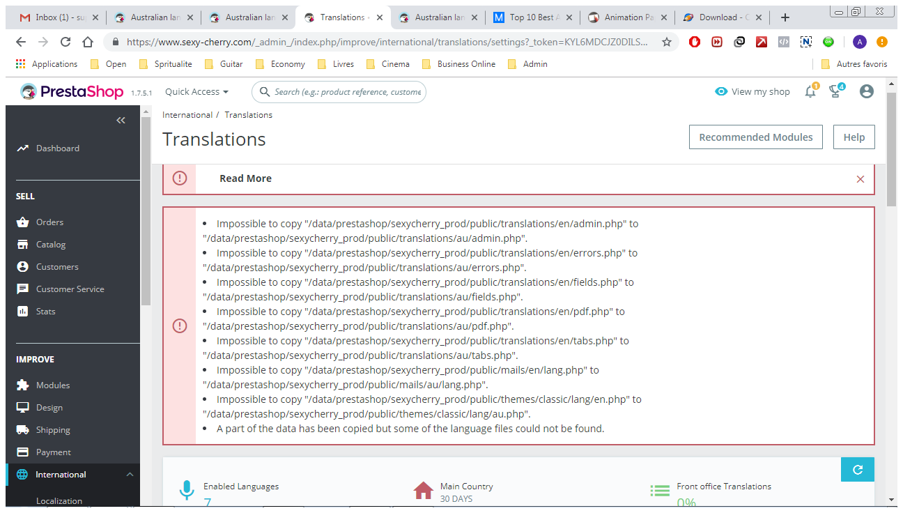

i tried your suggestion but i have bunch of errors when i do so :
btw, even if there is no error, i'll be able to copy ONLY the themes (classical, or mine, named 'Warehouse') translations, nothing else. Anywaym it's not working...
I don't like the text "it's not working". It sounds passive.
Did you investigate why the copying doesn't work? Is the source file not there? Or is there a rights problem with the target location. The latter - what I consider the most likely option - would point to a misconfigured server that has nothing to do with Prestashop.

For clarity, here, again, my errors when i try to copy the classic theme. I have EXACTLY same errors if i try to copy my Warehouse theme.

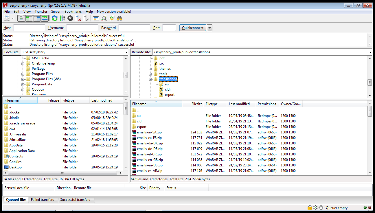

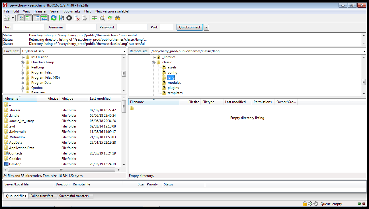

>>> I don't have any "en" in the folder public/translations.... just one 'au' folder..
image.thumb.png.f8757acb190fb776b5320d4bfc57d87e.png>>>>

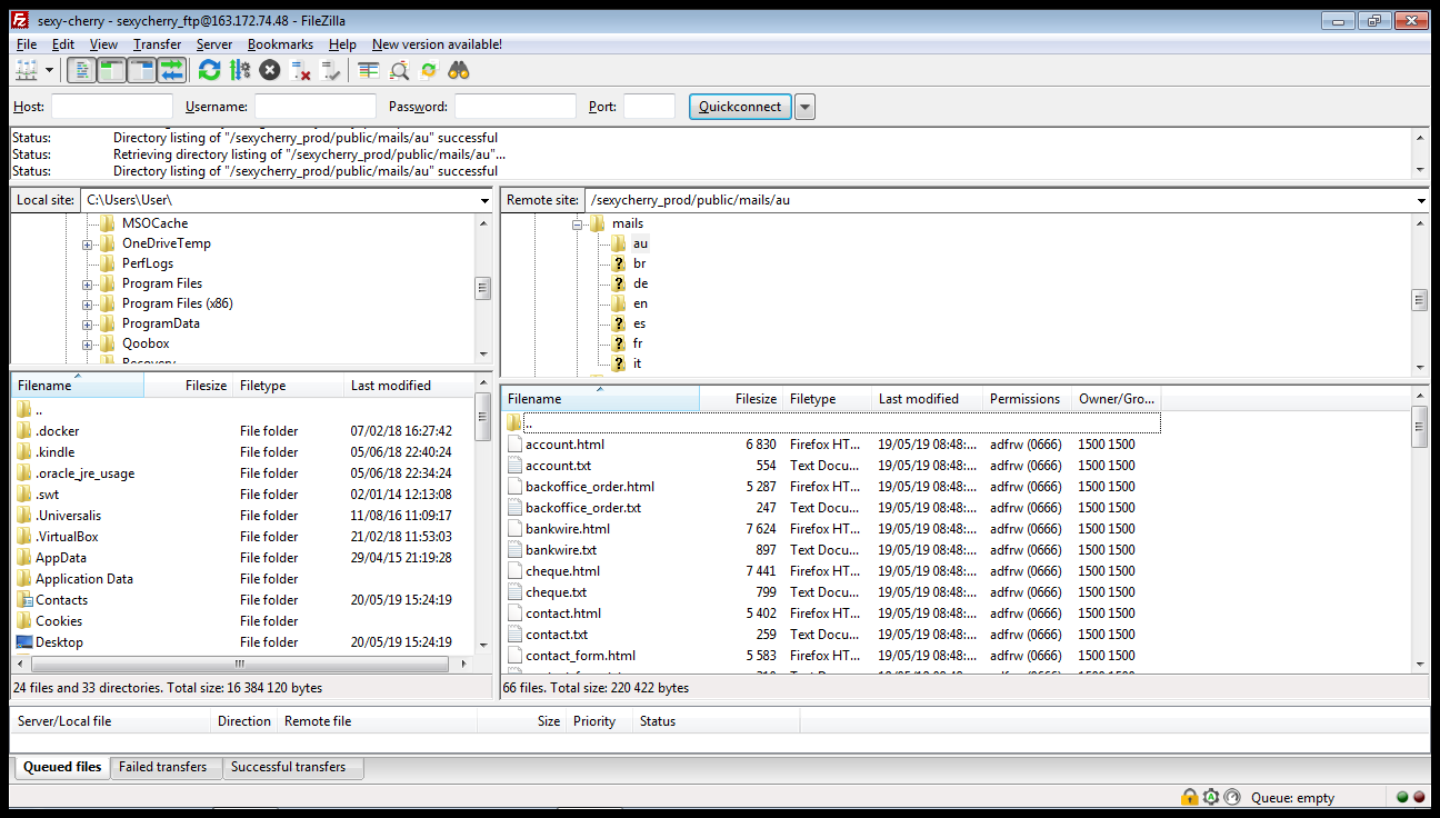

>>> i have the folders EN and AU in public/mails, but EN folder has 74 files while AU folder has 65 files only...
>>> in themes / classic / lang, there is NO FOLDER at all......

1/ clearly, the 'copy language' function doesn't 'understand/match' my file structure. On my side, that's the main problem. If i can copy the Themes translations, 99% of the work will be done..............
Moreover, i cannot localize WHERE are the translations files :
- theme/Warhouse/translations , everything is empty (EN-us, FR-fr.... folders are empty)
- theme/Warhouse/lang is empty too...
- theme/classic/translations, it's empty too..........................
- public/translations..... empty .................................
2/ 'A part of the data has been copied but some of the language files could not be found'.... this is what it is said.
So, some files have been copied, but i cannot know what files exactly (except if i try to backtest on a 'clean' prestashop, but that will take hours and headaches for no practical results...).... from before, i assume the files from 'public/mails' have been copied only, cause all the other folders are EMPTY....................

1.7.6.1 its the same mess. On one of my ps sites I'm trying to edit the default language of a child of the classic theme but in order to do so I need to copy the language from the classic theme to the child theme but no language files reside within the classic theme - i get this stupid error message:
Quote
Impossible to copy "/var/www/ps/themes/classic/lang/en.php" to "/var/www/ps/themes/my-child-theme/lang/en.php".
A part of the data has been copied but some of the language files could not be found.
