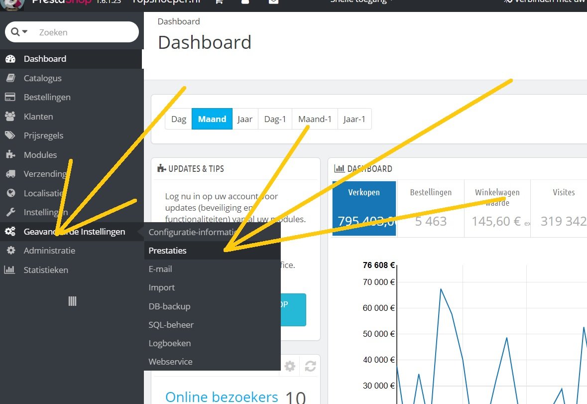

musicmaster Posted May 18, 2019 Share Posted May 18, 2019 On 5/15/2019 at 9:11 AM, makis_best said: In my installation There is no option like that. Yes, you do have. In the backoffice: Advanced Settings -> Performance and then the second last option Link to comment Share on other sites More sharing options...

musicmaster Posted May 20, 2019 Share Posted May 20, 2019 Link to comment Share on other sites More sharing options...
