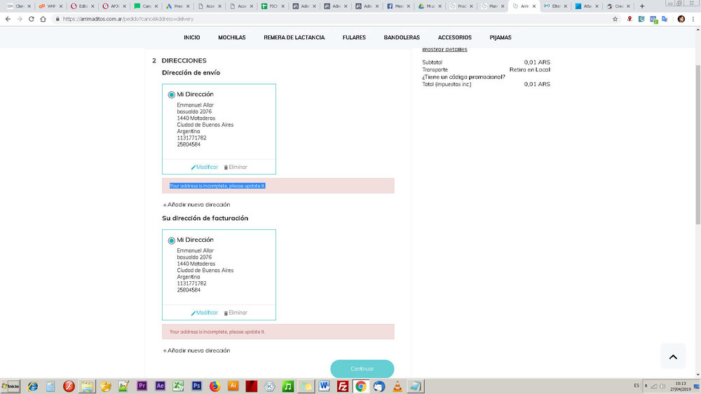

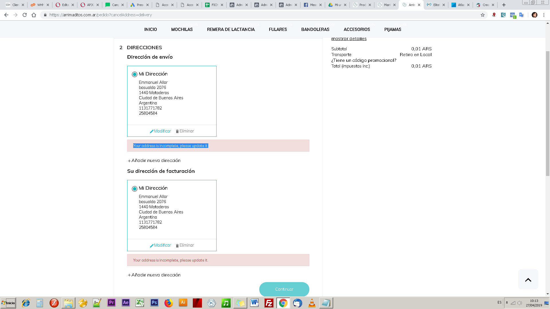

cuanticum Posted April 27, 2019 Share Posted April 27, 2019 Hola, tengo un problema, de la nada empezo a tirar este error a cualquier usuario que quiere comprar: Your address is incomplete, please update it. tengo version 1.7.1.5. Adjunto el error. Gracias! Link to comment Share on other sites More sharing options...

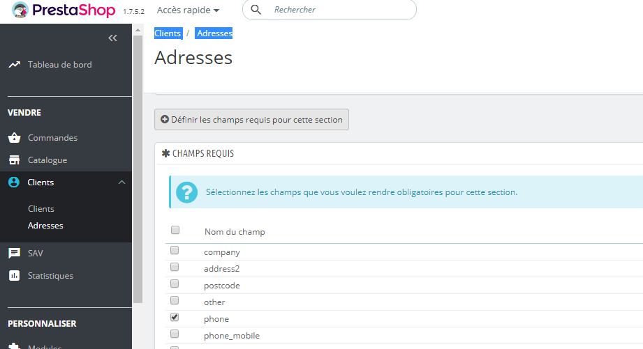

mohamedaitbella Posted July 31, 2019 Share Posted July 31, 2019 hello I had the same error, it was because I made an extra field required, to fix this if your case is the same as my go to BackOffice Clients -> Adresses in the bottom you gonna find a button click on it a list of fields name gonna show uncheck any field that you don't have in your address form , that's it for me Link to comment Share on other sites More sharing options...

gusman126 Posted August 1, 2019 Share Posted August 1, 2019 Como dicen por ahi. 2 cosas Actualiza minimo a la 1.7.5.2 Comprueba no tengas algun campo en pais o direcciones que lo tengas como obligatorio y que no se muestra en el formulario. Entra en editar la dirección y mira cual es el que falta, ve al pais y añade el campo que falta en el listado de campos Link to comment Share on other sites More sharing options...
