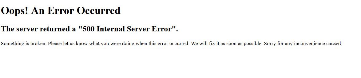

carling geston Posted April 20, 2019 Share Posted April 20, 2019 hello every one I have an issue with my prestashop 1.7.5.1 version. After i tried to install a free whatsapp module, i couldn't access the module manager any more. It shows me a 500 internal server error. But all the others settings are working. can some one help me figure out my problem? thanks in advance. Link to comment Share on other sites More sharing options...

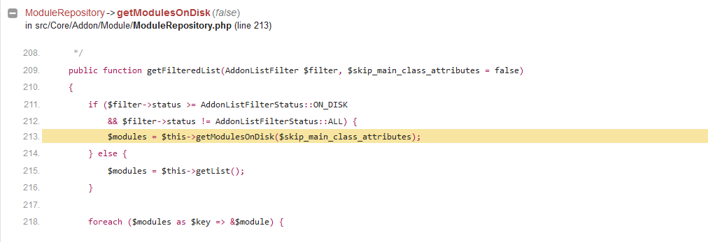

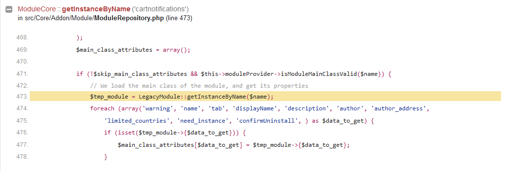

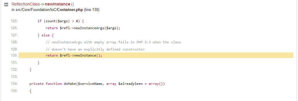

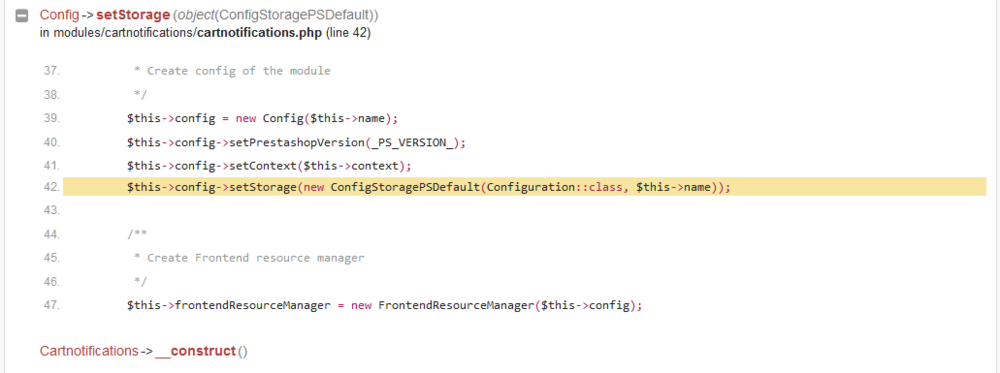

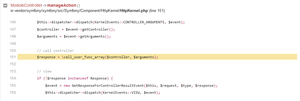

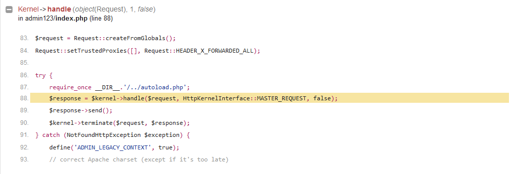

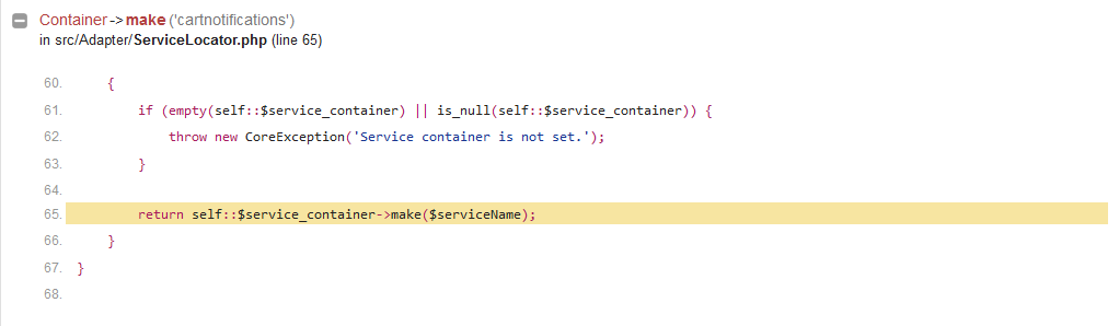

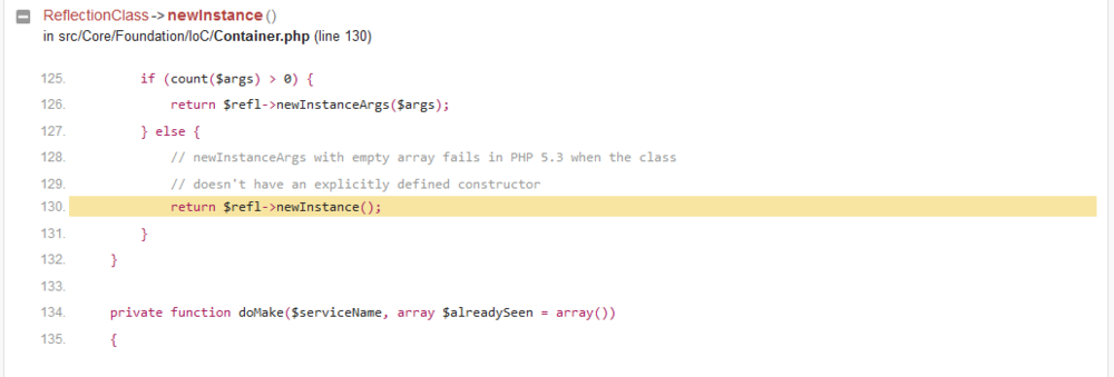

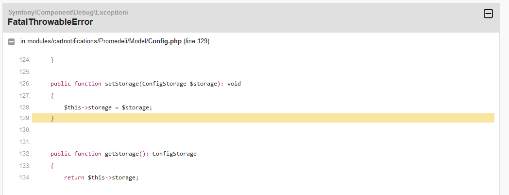

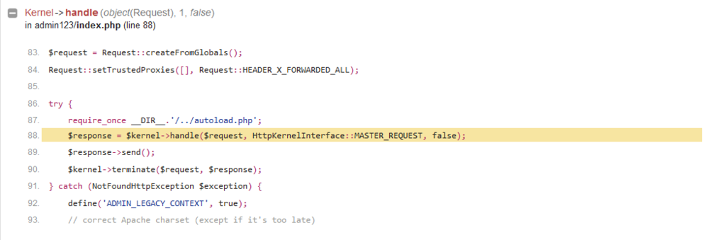

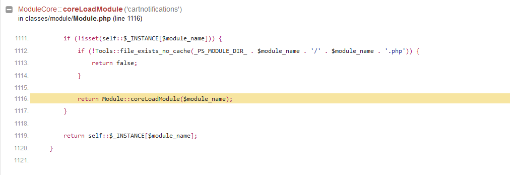

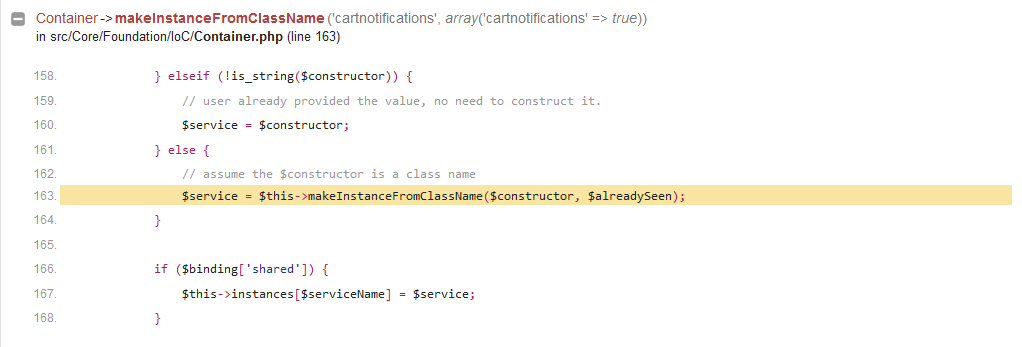

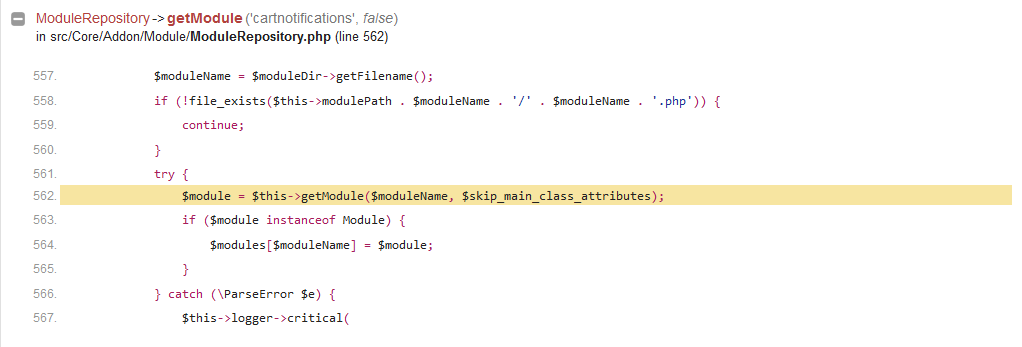

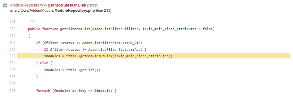

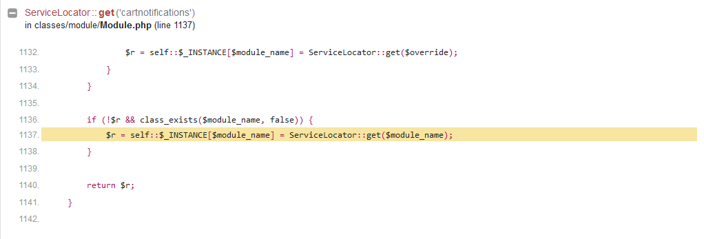

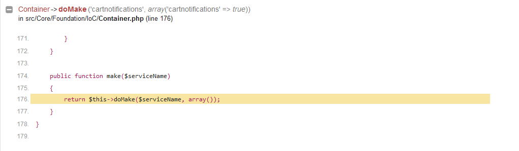

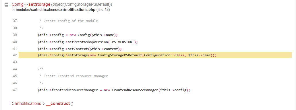

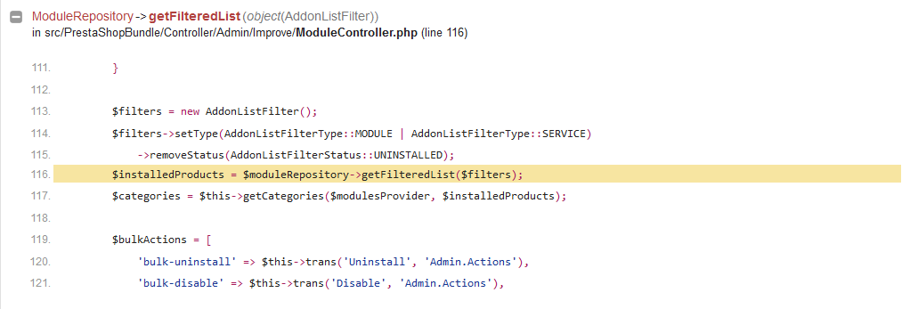

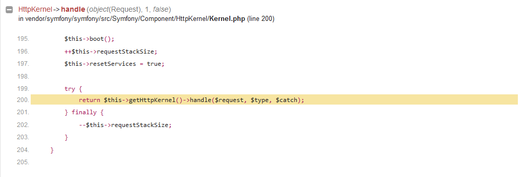

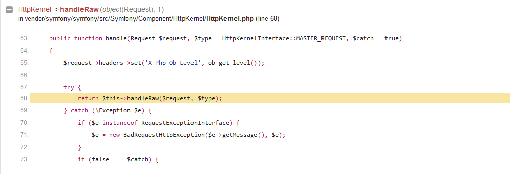

carling geston Posted May 31, 2019 Author Share Posted May 31, 2019 Here is the hole code. I splitted it into parts : 1) 2) 3) 4) 5) 6) 7) 😎 9) 10) 11) 12) 13) 14) 15) 16) Link to comment Share on other sites More sharing options...
JBW Posted June 3, 2019 Share Posted June 3, 2019 (edited) The error is caused by Module "cartnotifications" - try to reset/reinstall it. If this doesn't help deactivate it and ask the module developer for support. If you are are unable to access module manager at the moment, rename the module's directory on your server to cartnotification_old to deactivate it. Edited June 3, 2019 by JBW (see edit history) Link to comment Share on other sites More sharing options...
