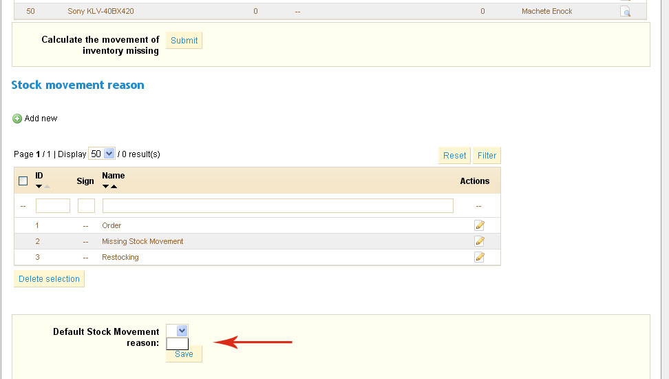

enock Posted November 2, 2011 Share Posted November 2, 2011 Hi, Please see below, my stock movement reasons do not appear: Link to comment Share on other sites More sharing options...
varinder Posted February 23, 2012 Share Posted February 23, 2012 Hi Guys, i also faced the same issue in updating the prestashop 1.3 to 1.4. Did lot of RND but didn't got the solutons. At last after spending lot of time i found one permanent solutions to the problem. First of all, the problem rises because there is no option called "Stock Movements" in Prestashop 1.3 and this is the new feature added to the Prestashop 1.4. So the when we add new product it checks for the value of "id_mvt_reason" in the Product class which returns -1 which in-return creates problem in adding new product. Solution: We don't have to make any modification anywhere in the Database; what we need to do is just go to "Tools.php" file inside classes folder and look for the getValue$key, $defaultValue = false) function in that. It would be on line no. 208 i guess not sure it depends upon the changes in the file. Just replace the following code in that function: return !is_string($ret)? $ret : stripslashes($ret); with if($key != 'id_mvt_reason') return !is_string($ret)? $ret : stripslashes($ret); else return 1; And just upload the file and check. Your problem goes away forever. Please Note: I'm not aware of the "Stock Movement" functionality; and those who knows please check that doesn't break their code. Cheers Guys!!! Varinder Singh Link to comment Share on other sites More sharing options...
