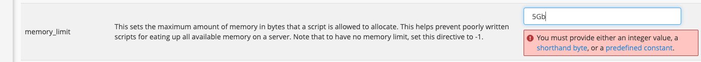

DESIGNCENTER__ Posted April 13, 2019 Author Share Posted April 13, 2019 Ya, entiendo, ingrese y pude hacer el cambio solo en 5G pero ahora esta peor me da mas errores, no me deja poner 5GB te adjunto ambas capturas de pantalla, En 5G que me deja hacer el cambio lo actualizo y me da todos estos errores. (1/1) ContextErrorException Notice: SessionHandler::gc(): ps_files_cleanup_dir: opendir(/var/cpanel/php/sessions/ea-php71) failed: Permission denied (13) in StrictSessionHandler.php line 101 at StrictSessionHandler->gc(1440)in SessionHandlerProxy.php line 83 at SessionHandlerProxy->gc(1440) at session_start()in NativeSessionStorage.php line 145 at NativeSessionStorage->start()in NativeSessionStorage.php line 295 at NativeSessionStorage->getBag('attributes')in Session.php line 256 at Session->getBag('attributes')in Session.php line 278 at Session->getAttributeBag()in Session.php line 73 at Session->get('_security_main')in ContextListener.php line 89 at ContextListener->handle(object(GetResponseEvent))in WrappedListener.php line 46 at WrappedListener->handle(object(GetResponseEvent))in TraceableFirewallListener.php line 35 at TraceableFirewallListener->handleRequest(object(GetResponseEvent), object(Generator))in Firewall.php line 84 at Firewall->onKernelRequest(object(GetResponseEvent))in FirewallListener.php line 48 at FirewallListener->onKernelRequest(object(GetResponseEvent), 'kernel.request', object(TraceableEventDispatcher))in WrappedListener.php line 111 at WrappedListener->__invoke(object(GetResponseEvent), 'kernel.request', object(ContainerAwareEventDispatcher))in EventDispatcher.php line 212 at EventDispatcher->doDispatch(array(object(WrappedListener), object(WrappedListener), object(WrappedListener), object(WrappedListener),object(WrappedListener), object(WrappedListener), object(WrappedListener), object(WrappedListener), object(WrappedListener), object(WrappedListener),object(WrappedListener), object(WrappedListener), object(WrappedListener), object(WrappedListener)), 'kernel.request', object(GetResponseEvent))in EventDispatcher.php line 44 at EventDispatcher->dispatch('kernel.request', object(GetResponseEvent))in TraceableEventDispatcher.php line 143 at TraceableEventDispatcher->dispatch('kernel.request', object(GetResponseEvent))in HttpKernel.php line 127 at HttpKernel->handleRaw(object(Request), 1)in HttpKernel.php line 68 at HttpKernel->handle(object(Request), 1, false)in Kernel.php line 200 at Kernel->handle(object(Request), 1, false)in index.php line 88 Link to comment Share on other sites More sharing options...
Rodrigo B Laurindo Posted April 14, 2019 Share Posted April 14, 2019 Si, tiene que ser 5G. Ahora te da error de permissiones en la carpeta de GC. En el mismo PHP.ini busca por session.save_path y cambia para /tmp Link to comment Share on other sites More sharing options...
