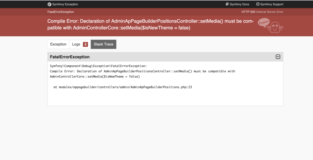

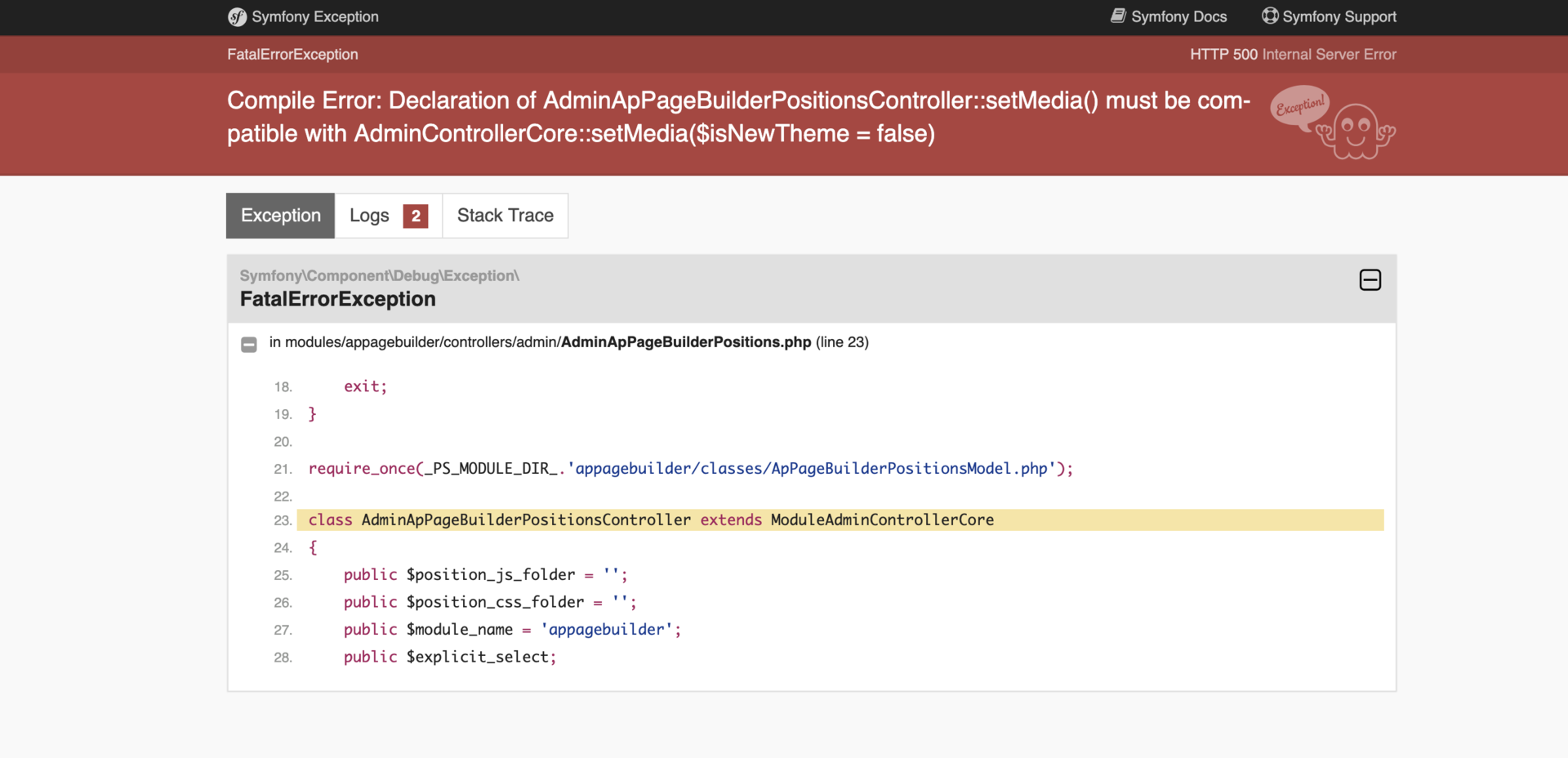

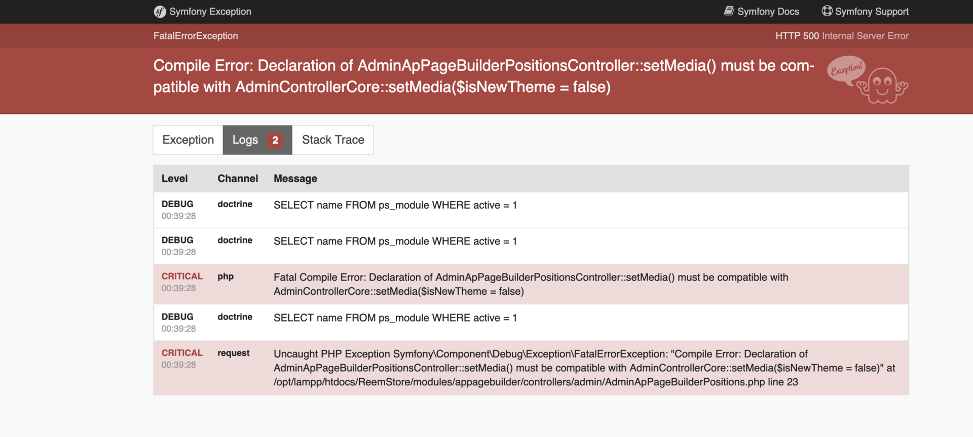

saraas Posted April 8, 2019 Share Posted April 8, 2019 i'm try to change the theme of my prestashop but when i open the back office that error shows to me: https://f.top4top.net/p_1193on9rm1.png https://a.top4top.net/p_1193myn5v2.png https://b.top4top.net/p_1193ralfc3.png please how can i solve it I hope to find a solution to this problem and not lose my all work i read the problem in the url picture but i dont know what exactly should i do please anyone can help. php Link to comment Share on other sites More sharing options...
MigrationPro Posted April 9, 2019 Share Posted April 9, 2019 Hello, I checked your attached image and noticed that you are using some module under the name "appagebuilder". It seems this module using some overwrites which doesn't compatible the current structure of PS. In this case, I recommend you disable/remove this module or contact its developer. 2 Link to comment Share on other sites More sharing options...
