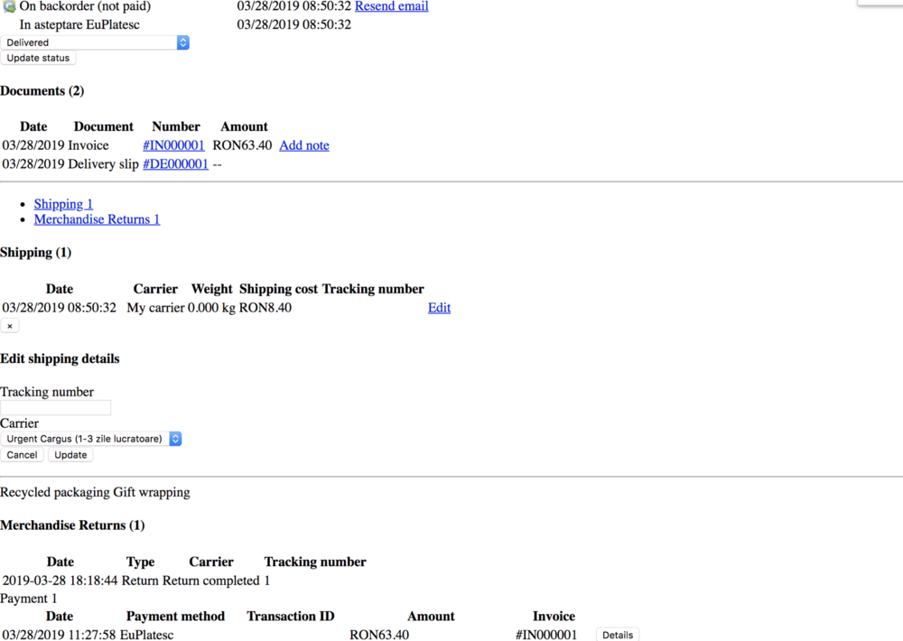

Abr87 Posted April 8, 2019 Share Posted April 8, 2019 Hi, Order detail page is not properly loaded when I access it from BO. I'm not sure but I think that the problem appeared after I installed some modules. I am new to Prestashop and I need to know how can I start to debug or fix this issue. Probably I need to revert some files that were override. Let me know if you have any clue. Thanks. Link to comment Share on other sites More sharing options...
musicmaster Posted April 8, 2019 Share Posted April 8, 2019 Try on the Advanced settings->Performance page to disable overrides and to disable non-Prestashop modules. That is a good place to start to debug. Link to comment Share on other sites More sharing options...
Rolige Posted April 9, 2019 Share Posted April 9, 2019 Hello: You have an error on a module hooked at displayAdminOrder. Find which modules are hooked there and you will find the module with the problem. If you disabled this module you should see your orders page correctly. Regards Link to comment Share on other sites More sharing options...
Abr87 Posted April 9, 2019 Author Share Posted April 9, 2019 Thank you guys. I've managed to fix the error. I found the module that generated the problem and I uninstalled it. Thank you. Link to comment Share on other sites More sharing options...
