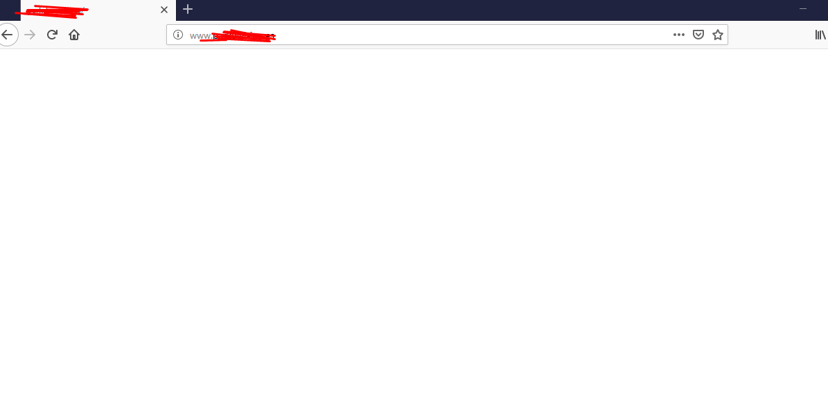

Steven_SSL Posted April 4, 2019 Share Posted April 4, 2019 Cuando quiero acceder con uno de los usuarios al backoffice me salta la pagina de error 404, he visto en otros temas muchas posibles soluciones pero ninguna me ha funcionado como: 1. Clear your browser cache and your cookies Try using Firefox instead of Chrome (which seems have some unexpected problems) <-- funciona a medias en modo incógnito pero haciendo F5 todo el rato y siempre me saca de la pagina Check PS_SHOP_DOMAIN and PS_SHOP_DOMAIN_SSL in ps_configuration table <--- ESTAS TABLAS NO LAS LOCALIZO O SE LLAMAN DE OTRA FORMA Manually clear smarty cache : remove all files from tools/smarty/compile and tools/smarty/cache Disable the IP check in classes/Cookie.php (this can causes many issues with dynamics IP) : in isLoggedBack(), remove or comment the fourth condition : AND (!isset($this->_content['remote_addr']) OR $this->_content['remote_addr'] == ip2long(Tools::getRemoteAddr()) OR !Configuration::get('PS_COOKIE_CHECKIP')) Make the expire time shorter for cookies (IE can have issues with longest time cookies) : in classes/Cookie.php constructor, set : $this->_expire = isset($expire) ? (int)($expire) : (time() + 3600); instead of $this->_expire = isset($expire) ? (int)($expire) : (time() + 1728000); 2.En Errores de Cpanel solo hay este tipo de error: [Wed Apr 03 13:59:21.531749 2019] [authz_core:error] [pid 30857] [client "IP"] AH01630: client denied by server configuration: /home/"nombre"/public_html/translations/cldr/datas/ He cambiado los permisos y aún así siguen saliendo. No se exactamente si es 775 o 777. 3. He activado el modo debug y el error que aparece es : /home/..../publi_html/vendor/symfony/symfony/src/Symfony/Component/httpFoundation/Session//Storage/Handler/StrictSessionHandler.php [8]SessionHandler:gc()ps_files_cleanup_dir:opendir(/var/cpanel/php/sessions/ea/-php56) Failed:Permission denied(13) LA URL ES ORIENTATIVA PARA NO DAR EL NOMBRE REAL Para solucionar este error debería de cambiar "/var/cpanel..." por "/tmp/cpanel.." pero tampoco funciona. En el tema donde encontré esta solución dicen que mi version de prestashop 1.7.4.2. debe de ir con PHP 7.1, es curioso por que en PHP multimanager me aparece que tengo el PHP5.6 y al cambiarlo al 7.1 la pagina web (frontoffice) queda en blanco totalmente . He llegado a un punto en el que me es imposible seguir. Adjunto imágenes de pagina en blanco, lo del modo incógnito no puedo darlo como solución si lo que quiero es acceder como a cualquier pagina de Internet. Gracias de antemano Prestahop: 1.7.4.2 PHP: 5.6 (ea-php-56) Link to comment Share on other sites More sharing options...
