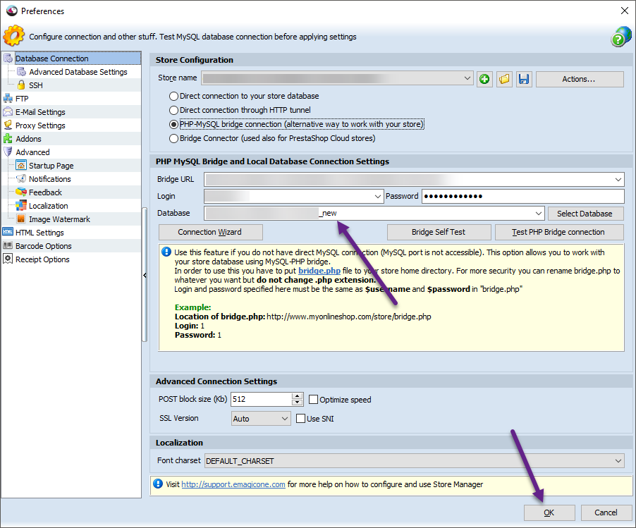

Alexandra Kolodovska Posted April 11, 2019 Share Posted April 11, 2019 Hello! Try to open Preferences (F12) and rename local database( for example, add ‘1” or “new” to the name ) , then click Ok and Get data from web. Let me know if the issue persists after that. Link to comment Share on other sites More sharing options...

Alexandra Kold Posted April 27, 2020 Share Posted April 27, 2020 Thank you for your reply. If you say it did not work at any time, first thing that comes in mind that antivirus software or Firewall can cause this issue. You can try to temporarily disable it to give the software a chance to connect to store. I can also recommend 2 steps that can help in solving this issue if you try it on Bridge type of connection: 1) rename local database, as it is mentioned in this post before; 2) delete the folder on your PC with your database name in "LocalMySQLData" folder (you can find this folder on your PC by this path: C:\Users\%username%\appData\Local\eMagicOne Store Manager for PrestaShop\LocalMySQLData\data\%database name%). Store Manager has to be closed before doing this operation. If the issue still occurs after the mentioned manipulations, contact Store Manager support on prestashopmanager.com, there is a Live Chat button and you'll receive assistance right away. 1 Link to comment Share on other sites More sharing options...
