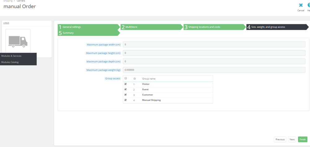

I have created a brand new shipping Carrier on the CMS and assigned to one of my shops within the website.

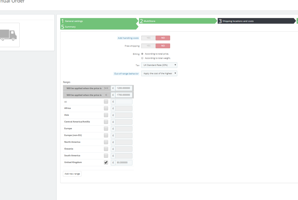

There are ranges for this particular shipping which will be applied when the (price is >= 1200  and price <1700).

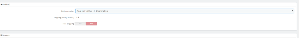

My objective is when adding an order through the back-office(CMS)  and when you get to the section where the shipping Drop down is the option is  not showing in the dropdown.
I've attached my configuration set up in this request.
I would be grateful if some could assist me towards the right direction.

Hi.
I know this topic is old, but i had the same problem when i was fresh to Prestashop.
Specifically, because you mentioned you have a multi-shop, this problem might occur because on the top - left you haven't chosen the specific Shop of yours nad by default 'all Shops' is chosen.
Hope this helps to someone.
