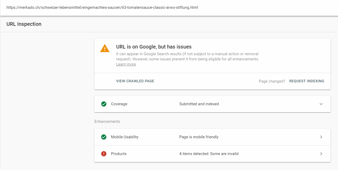

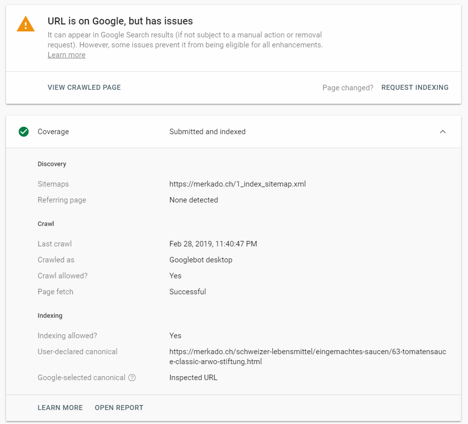

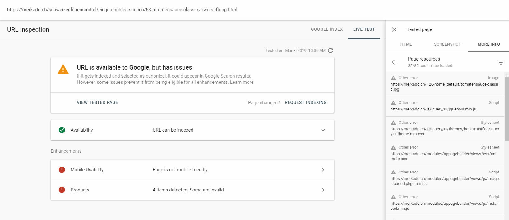

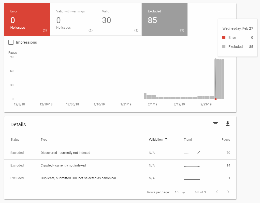

Oli4CH Posted March 8, 2019 Author Share Posted March 8, 2019 Thanks a lot @JBW for your feedback. Alright, I understand. You're right, the URL gets properly redirected in the browser. So in that case the XML export might be correct. Then the question is why is Google handling that XML sitemap by not indexing it. Do you think it could be connected while changing the setting of "redirect to the canonical url" ? The change was made on 26th Feb in the evening. 27th Feb appears a massive increase of excluded URLs. Maybe you or someone else can see something on those screens. Just an example of one URL: When I use the button "live testing" on the Search Console the product is found. There are also found quite some errors. I have some doubts that this might be conected to the robots.txt file as there quite a lot of folders and files are disallowed for crawling. I haven't change it so I am using the standard Prestashop robots.txt file. Link to comment Share on other sites More sharing options...
JBW Posted March 8, 2019 Share Posted March 8, 2019 What is shown it the error section "Products"? Coverage and Availablity is ticked green, so why do you think there are issues? Link to comment Share on other sites More sharing options...

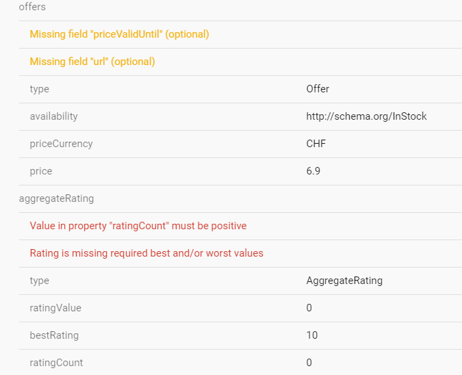

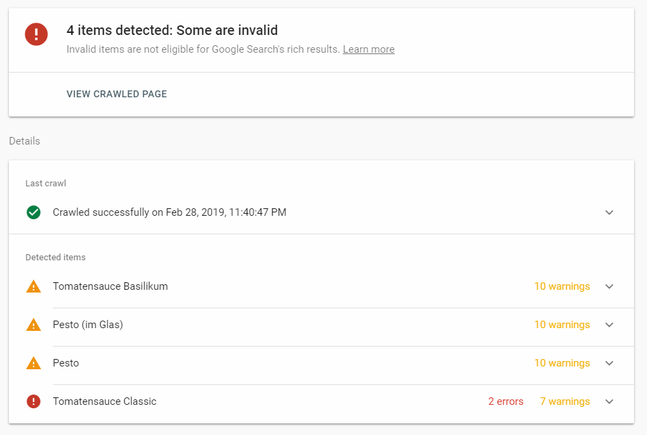

Oli4CH Posted March 8, 2019 Author Share Posted March 8, 2019 The point is that from one day to the other the excluded URLs went up from only 2 to 85, which is extremely bad for my visibility on Google. It happend just after I have changed the the setting of "redirect to the canonical url" in Prestashop. This might be just a coincidence but I do not believe that. I just checked the XML in one of my backups befire the 27th Feb and the URLs in the XML look the same. This means to me that the Google Sitemap module works well. Mostly there are only warnings so that shoudln't cause these kind of issues I suppose... I do not understand the two mentioned errors as there is no rating for the product. However, all the other excluded URLs (products) do only have warnings... So do you think the other errors from the last screen of my previous post are not causing any issues? Link to comment Share on other sites More sharing options...
