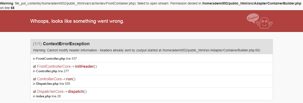

azamat1000 Posted March 4, 2019 Share Posted March 4, 2019 Hello. I have qwestion. I make prestashop 1.7.5 on my localhosting XAMMP. After try to transfer to live server cpannel. But got bug I think with "permission" usually in fonder "var". Presta say cannot do something. I change in that folder "var" or file permission to 777.After this bug like fix and happend next bug in folder "var" I do same and next. Default it is 644 for file and 755 for folders. I don know how to fix it or do right way. Do you what to to and how much it will cost. I alredy finish in my localhost just need coplete setting on live server. Link to comment Share on other sites More sharing options...
JBW Posted March 5, 2019 Share Posted March 5, 2019 You shouldn't have copied the cache folder at all to your live system. Try to rename var/cache to var/cache_old and see if the newly generated cache directory gets correct permissions. 1 Link to comment Share on other sites More sharing options...
