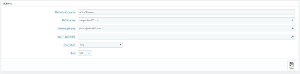

MAC87 Posted February 22, 2019 Share Posted February 22, 2019 (edited) Hi All, I have am trying to setup the SMTP email in Advanced Parameters > Email but i get the attached error when send a test email. What does this error mean? Can anyone suggest a possible fix please for me to try? The Credentials are 100% correct so it can't be that and the SMTP setting are copied from the Microsoft site and confirmed to be correct by our IT Team. Any suggestion, however small, would be greatly appreciated. Version - I am using Prestashop 1.7.4.2. Thank you. Edited February 22, 2019 by MAC87 Added PS Version to info (see edit history) Link to comment Share on other sites More sharing options...

MAC87 Posted February 27, 2019 Author Share Posted February 27, 2019 Thank you for the reply. It is possible but i have selected the correct port and encryption method from the list provided. What does this error mean? I maybe then able to narrow down the cause. I have tested this with my personal Gmail account and i get the same error. Link to comment Share on other sites More sharing options...
