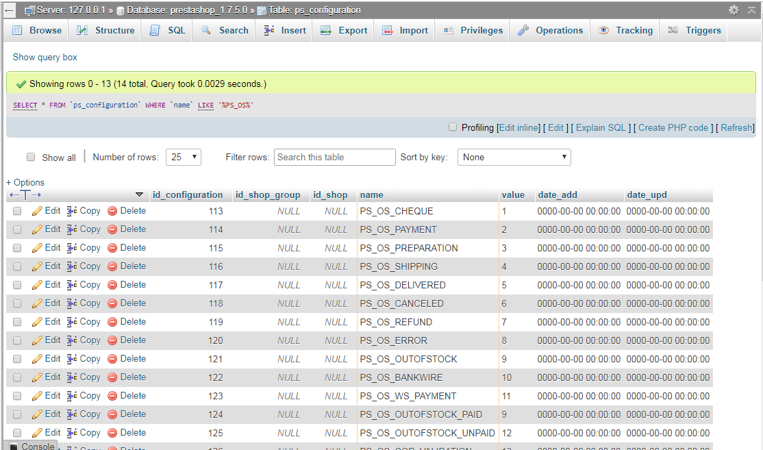

Nishith Nesdiya Posted February 20, 2019 Share Posted February 20, 2019 Hi.. the first you need to check the prestashop 'ps_configuration' table in your database like this query if your value exit or not ? SELECT * FROM `ps_configuration` WHERE `name` LIKE '%PS_OS%' if you not find then you need to add the new name with your value in 'ps_configuration' in my case see image Thanks 2 Link to comment Share on other sites More sharing options...
bonsaiko Posted February 20, 2019 Author Share Posted February 20, 2019 Thanks a lot, that's what I needed. Actually i did : SELECT * FROM ps_configuration WHERE value = '21' And I got the variable name that I was looking for, which is PS_OS_OUTOFSTOCK_UNPAID Thank you very much. Link to comment Share on other sites More sharing options...
