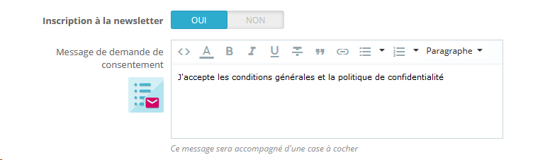

P i l o u Posted February 6, 2019 Share Posted February 6, 2019 Si, il se trouve bien dans la configuration du module, dans Personnaliser Link to comment Share on other sites More sharing options...

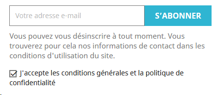

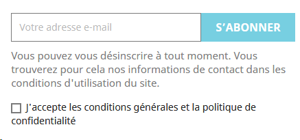

P i l o u Posted February 6, 2019 Share Posted February 6, 2019 Sur ma version de test, ça fonctionne: La couleur du bouton 'S'abonner' change si on coche ou non la case Link to comment Share on other sites More sharing options...
