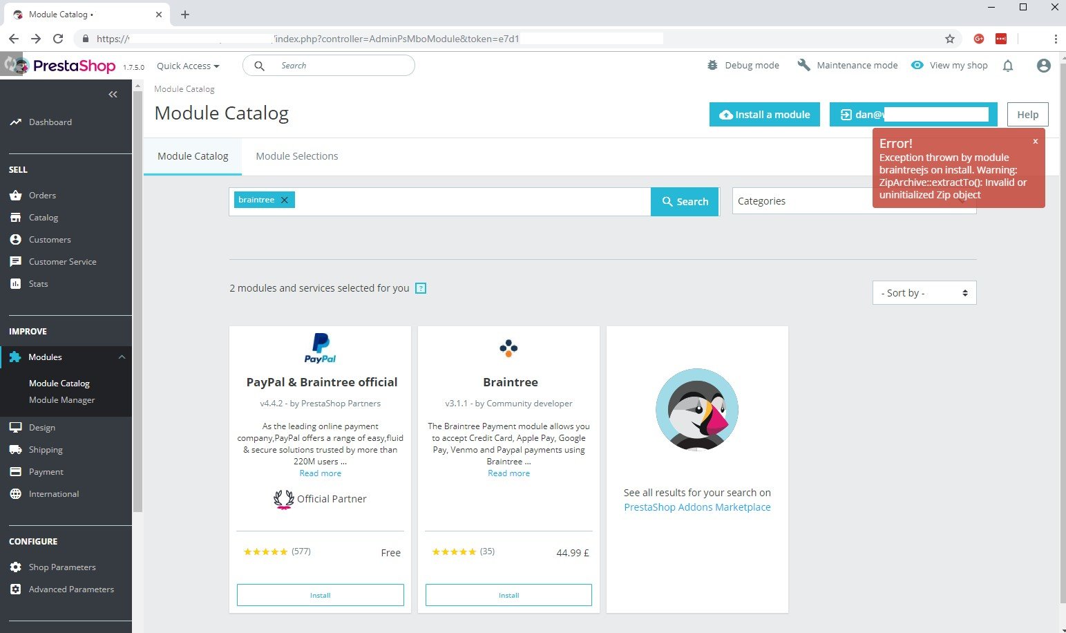

danrimer Posted January 23, 2019 Share Posted January 23, 2019 Hello I am a long time user of Prestashop. I am trying to migrate my store from 1.6 to 1.7 and have stumbled across this problem at the first step! I can't install modules that I have purchased from the addons website on my new server using the backoffice. If I go to the addons website and download them, I can then install them manually without problems. However, I would like to know where the problem lies so that it can be fixed! The image attached shows the error I receive when I try to install the BrainTree payments module that I have purchased. The error message is: "Error! Exception thrown by module braintreejs on install. Warning: ZipArchive::extractTo(): Invalid or uninitialized Zip object". I have tested the server using phpinfo() and zip support is included. Zip Zip enabled Zip version 1.15.4 Libzip version 1.1.2 If it helps, I have a dedicated server running cPanel with PHP 7.2, although my current site isn't residing on this server. Also, the test site has a different URL to the normal site - could this be the reason that the addons aren't being downloaded? I'm unsure where to go next. If anyone can point me in the right direction or if there's a better forum for this problem, please let me know! Thanks Dan Link to comment Share on other sites More sharing options...

danrimer Posted January 24, 2019 Author Share Posted January 24, 2019 (edited) @tdsoft Thank you for your reply. I'm the hosting provider. It's my dedicated server. AFAIK, Zip is enabled in PHP - that's why I showed the output from phpinfo(). Is there something I'm missing? I have tried uninstalling php_zip and reinstalling it. When it is uninstalled, the modules page fails silently when trying to install. Once reinstalled the page fails as above. Interestingly, if I try to add a free module (I just tried "Advertising Block") it works fine. It's just for the paid for modules that it doesn't work. Again, I can download the module to my PC and then install directly using the "Upload a module" button. The module installs perfectly (if slowly!). Edited January 24, 2019 by danrimer (see edit history) Link to comment Share on other sites More sharing options...
tdsoft Posted January 25, 2019 Share Posted January 25, 2019 This happend when trying to update a module bought on the addon store but when user is not connected to psaddon (or connected with another account). No zip is downloaded, so it can't be extracted... Link to comment Share on other sites More sharing options...
danrimer Posted January 25, 2019 Author Share Posted January 25, 2019 @tdsoft Thank you for your reply. I AM logged into psaddon. Please see my screenshot - i've simply removed the second half of my email address in the picture. I agree, the symptoms appear the same as if I was not logged in, but the module list also says "install" rather than "discover". This proves that the login has worked. All my modules show up correctly (with the option to Install rather than Discover). Link to comment Share on other sites More sharing options...
