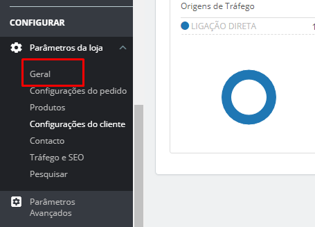

rafael1978 Posted January 22, 2019 Share Posted January 22, 2019 Boa noite, necessito de ajuda num problema que estou a ter com uma loja Prestashop Eu fiz o upgread para a nova versão 1.7.5, de uma versão anterior, acontece que está tudo a funcionar bem excepto a ligação (Parametros da Loja>>Geral). Ao clicar nesta ligação o site reporta-me o seguinte erro: Oops! An Error Occurred The server returned a "500 Internal Server Error". Something is broken. Please let us know what you were doing when this error occurred. We will fix it as soon as possible. Sorry for any inconvenience caused. Alguem tem alguma ideia de como resolver este bug? Obrigado desde já. Link to comment Share on other sites More sharing options...
selectshop.at Posted January 24, 2019 Share Posted January 24, 2019 O que dizem os logs de erro do servidor ? Link to comment Share on other sites More sharing options...
rafael1978 Posted February 1, 2019 Author Share Posted February 1, 2019 On 1/24/2019 at 1:26 AM, selectshop.at said: O que dizem os logs de erro do servidor ? Enabling the "sensio_framework_extra.router.annotations" configuration is deprecated since version 5.2. Set it to false and use the "Symfony\Component\Routing\Annotation\Route" annotation from Symfony itself. Link to comment Share on other sites More sharing options...
selectshop.at Posted February 2, 2019 Share Posted February 2, 2019 Vc. está usando um tema ou módulos próprios, que nao sejam os nativos ? Versao php em uso ? Link to comment Share on other sites More sharing options...
rafael1978 Posted February 3, 2019 Author Share Posted February 3, 2019 A versão php é a 5.6 e os modulos não nativos estão todos desativados Link to comment Share on other sites More sharing options...
selectshop.at Posted February 4, 2019 Share Posted February 4, 2019 Versao php 5.6. com PS 1.7.5. nao vai dar. Use uma versao php 7.0. De preferencia php 7.2. Link to comment Share on other sites More sharing options...
rafael1978 Posted February 10, 2019 Author Share Posted February 10, 2019 On 2/4/2019 at 4:07 PM, selectshop.at said: Versao php 5.6. com PS 1.7.5. nao vai dar. Use uma versao php 7.0. De preferencia php 7.2. Obrigado já reparei que tem mesmo alguns parametros em falta nos requisitos. Link to comment Share on other sites More sharing options...
