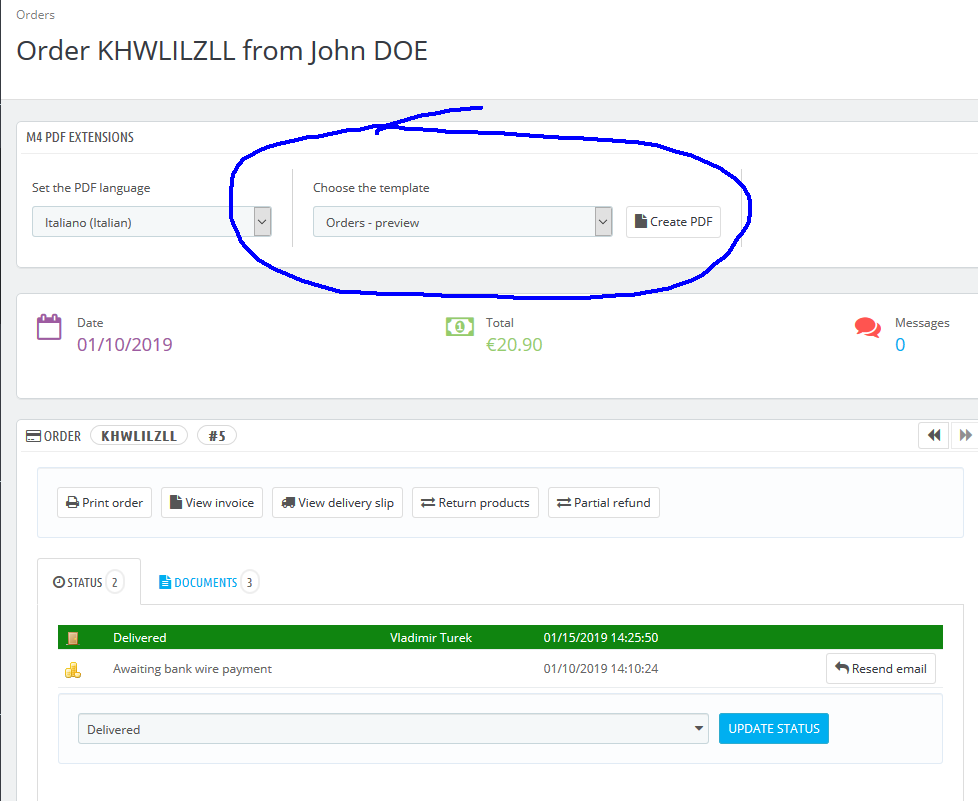

tuk66 Posted January 29, 2019 Share Posted January 29, 2019 This issue isn't fixed at the moment. M4 PDF Extensions customers can print order details using the Orders - preview template - https://www.presta-addons.com/pdf/Orders - preview.pdf - and in the latest version (2.5.0) also easily on the page. Link to comment Share on other sites More sharing options...
