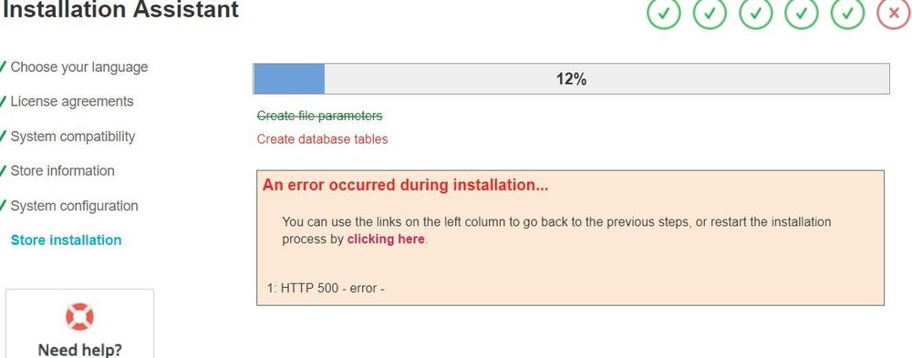

a.ila Posted January 15, 2019 Share Posted January 15, 2019 I'm trying to go through the installation wizard for PS 1.7.5.0 on Apache 2.4.37, PHP 7.1.25, MySQL 5.7.19, Debian 8 I am stuck on the step "Create table" and I unfortunately I don't have any clue on what is causing the installation to fail. The message don't give enough details on the issue itself. I've looked at both Apache log file and MySQL, frankly I don't see any error. As anyone any idea on where to find error details during the installation? It's getting quite frustrating. MySQL 2019-01-15T16:22:43.469714Z 71 Connect prestashop@localhost on using Socket 2019-01-15T16:22:43.470033Z 71 Query SELECT @@auto_increment_increment as aii 2019-01-15T16:22:43.470295Z 71 Query SELECT @@auto_increment_offset as aio 2019-01-15T16:22:43.470742Z 71 Quit 2019-01-15T16:22:43.471314Z 72 Connect prestashop@localhost on prestashop using Socket 2019-01-15T16:22:43.472064Z 72 Query CREATE TABLE `ps_test` ( `test` tinyint(1) unsigned NOT NULL ) ENGINE=MyISAM 2019-01-15T16:22:43.480873Z 72 Query DROP TABLE `ps_test` 2019-01-15T16:22:43.481090Z 72 Quit Apache Link to comment Share on other sites More sharing options...

JBW Posted February 15, 2019 Share Posted February 15, 2019 Set _PS_MODE_DEV_ to true in file config/defines.inc.php to see the details about the 500 error /* Debug only */ if (!defined('_PS_MODE_DEV_')) { define('_PS_MODE_DEV_', true); } Link to comment Share on other sites More sharing options...

a.ila Posted February 22, 2019 Author Share Posted February 22, 2019 (edited) The installation wizard lacks details when things don't work out of the box. I finally solved all the issues by searching for the youngest/last modified files, which usually are the logs. In fact within Prestashop directory, there are quite few which do have details. find /apache/prestashop -type f -printf "%T@ %p\n" | sort -n | cut -d' ' -f -2 | tail -fn5; In my case, they were mostly caused by php configurations (php.ini), dependencies and file permission. If you face this type of issues, you've better chances to fix it with direct SSH access and some control on Apache/PHP Edited February 22, 2019 by a.ila (see edit history) Link to comment Share on other sites More sharing options...
