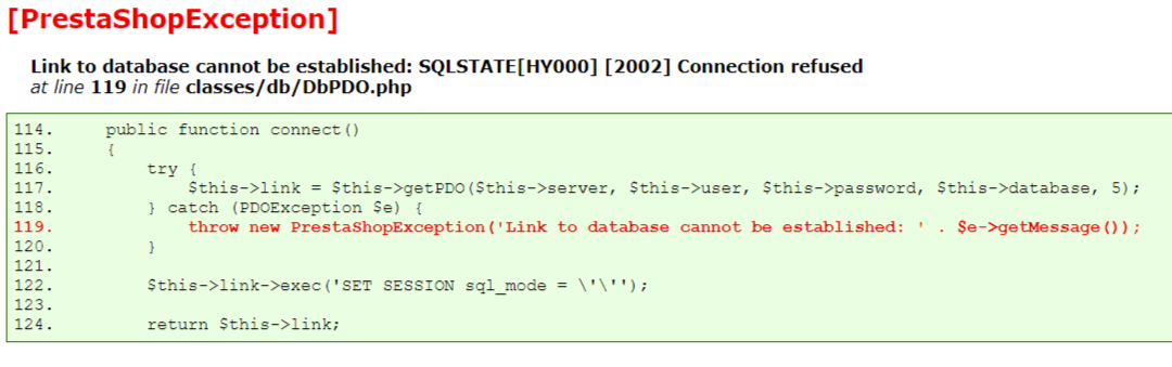

haitam.chtiba@gmail. Posted October 17, 2023 Share Posted October 17, 2023 Hi everyone I'm facing the same problem after upgrading from MySQL 5.7 to MySQL 8.0 My website can no lounger connect to database can you please explaine to me what to do exactly to solve the problem ? Thank you Link to comment Share on other sites More sharing options...
