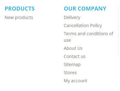

kibiribi Posted March 11, 2019 Share Posted March 11, 2019 I've got the same problem I tried to mode up-down link positions -so, id was changed from 10 to 2 all was sorted in Backend fine, but on FronEnd sort order of links was bad. ver. 1.7.4.4 here it is a screenshot - 1 Link to comment Share on other sites More sharing options...

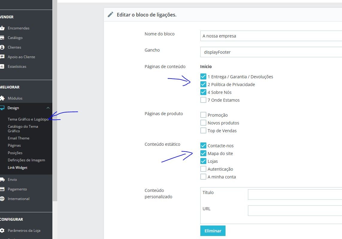

PCQUATRO Posted November 5, 2019 Share Posted November 5, 2019 On 1/6/2019 at 12:52 PM, dante_matusca said: I have searched everywhere but couldn't find how to sort the our company link list in the footer of prestashop 1.7.4.2. All i need is to put the "About Us" and "Contact Us" to be in the first second line of the list respectively. I kindly require your help thanks in advance Sort it in Design -> Pages than go to Design -> Graphics Theme -> Homepage Configuration -> Footer -> Connections List -> Remove all the check marks -> save -> put the check marks back -> save Best Regards 3 Link to comment Share on other sites More sharing options...
MUSH Posted November 6, 2019 Share Posted November 6, 2019 This steps are working ! @PCQUATRO thanks for advance ! Link to comment Share on other sites More sharing options...
