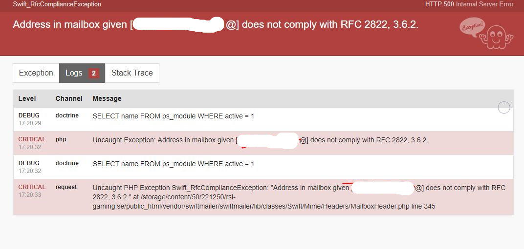

gorkij Posted December 25, 2018 Author Share Posted December 25, 2018 23 minutes ago, Crezzur said: Turn on your error debug to see what the issue is. You could try to remove the @ symbol or to change the wrong mail adress to a correct one. I have debug on. My customer has entered his adress, complete with @gmail.com in this example. The stack trace and logs give the following: "Address in mailbox given [customer.customer@] does not comply with RFC 2822, 3.6.2." Now, bar me being completely stupid : How would I remove the @-symbol from a mail address when PS isn't relaying the entire address internally? He's entered a correct address, I just mailed him on an missing item-point and it goes through. Link to comment Share on other sites More sharing options...
gorkij Posted December 26, 2018 Author Share Posted December 26, 2018 Right. I might not be the brightest PHP-wrench in the box, but the error is still around. Check the attachment : it just forwards the first part of an email adress up to the at-sign which in turn creates an exeption since it's not a valid adress. Knocking my nogging tells me that this is an error in MailboxHeader.php somehow. Now; anyone know how to adress this? The email adress given by my customer is correct. This happens for all customers. Including at checkout, causing payment module faults. (Yes, I *could* turn off all emails to customers. But that'd be stupid so no.) Link to comment Share on other sites More sharing options...
