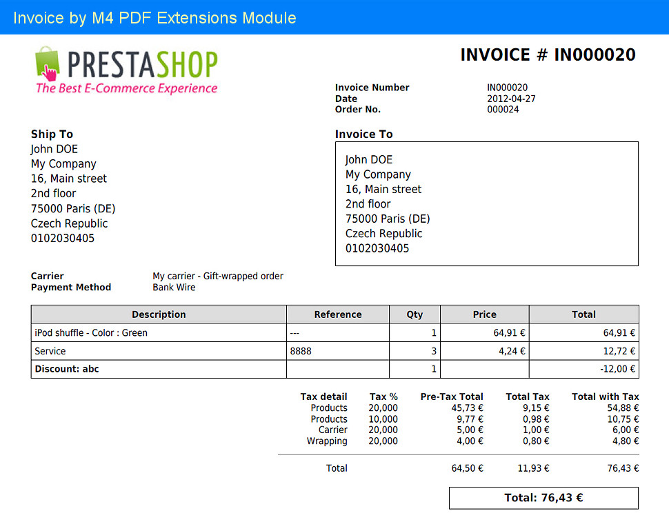

tuk66 Posted April 25, 2014 Share Posted April 25, 2014 Here is an example how it could look - http://www.presta-addons.com/pdf/invoice-1.4.6.2-m4pdf.jpg Link to comment Share on other sites More sharing options...
