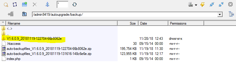

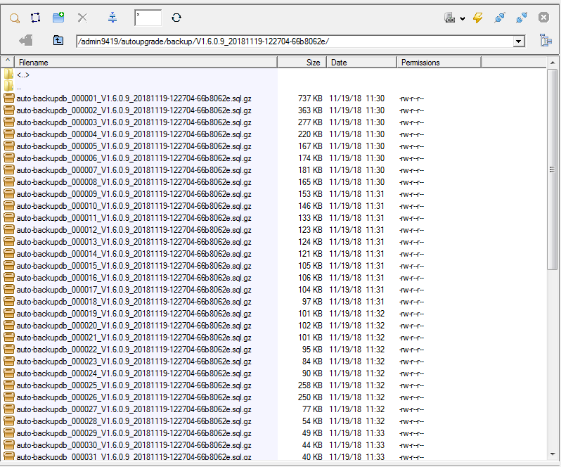

MinaMina Posted November 29, 2018 Author Share Posted November 29, 2018 (edited) 3 hours ago, NSN said: The easiest way to solve your problem would be to copy your backup of the website and database back to the server. Afterwards you can decide if you want to stay with your current shop and change your hosting provider or you go step by step by step in updating. So from 1.6.0.9 to an 1.6.1.x version and than if that version works make the next step to 1.7.x Hi! Thanks for answering! I guess I know how to restore the database (althouth I haven't tried that before either) but I'm not sure how to copy the backup the website. The backup files (.sql.gz) show in the picture bellow are database, right? And (.zip) files show in this picture bellow ("backup" files in Autoupgrade) must be backup of the website? How should I use them to restore the earlier version? I can no longer go in the shop or the Backoffice, so I guess I have to restore it by FTP... The picture bellow is how the root files look like - Can you please teach me how to do it? Thanks a lot in advance! Edited November 29, 2018 by MinaMina (see edit history) Link to comment Share on other sites More sharing options...

MinaMina Posted November 29, 2018 Author Share Posted November 29, 2018 No, I don't have it. The automated backup service from my webhotel is not for free, and I didn't buy the service. I checked the files I have on the server, under Autoupgrade/Backup, there's a fileholder called "V1.6.0.9_201811119...." In this holder there are many files, looks like the ones I backuped on Nov.19. and they all look like database files, but I don't know why so many... Link to comment Share on other sites More sharing options...
