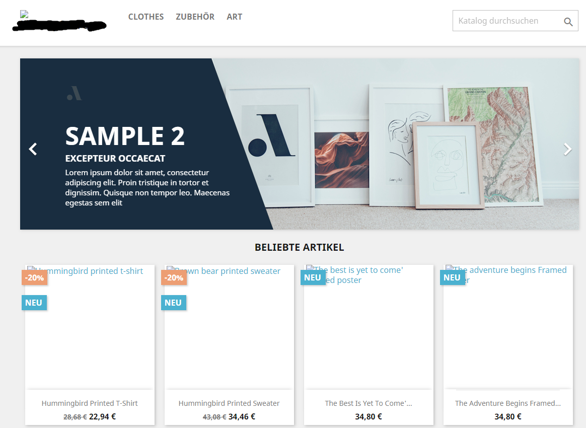

The installation process just finishes normal. But when I try to access the frontpage, there are many images missing (see screenshot). Also if I replace an image with another image, it still doesnt work.
