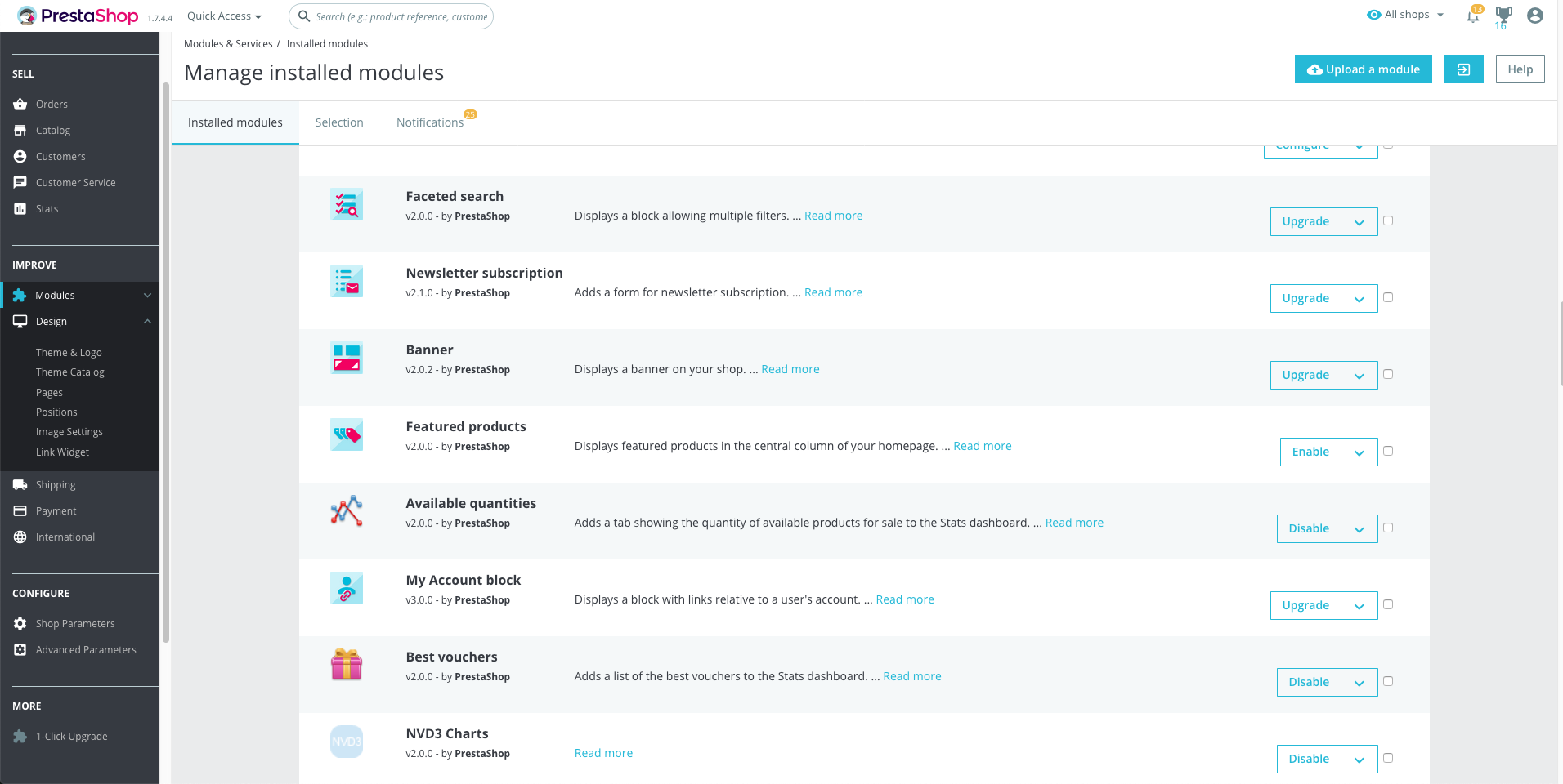

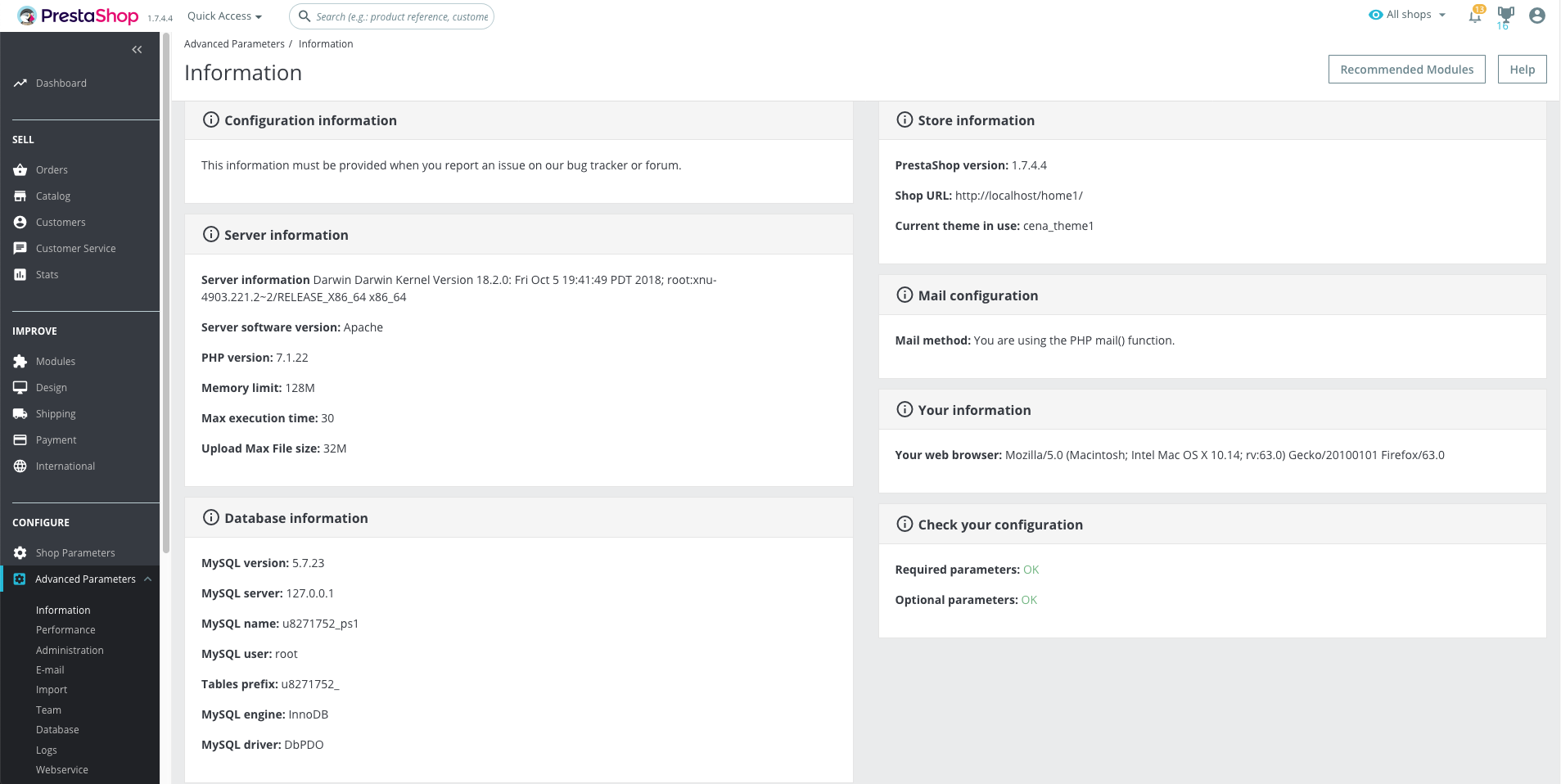

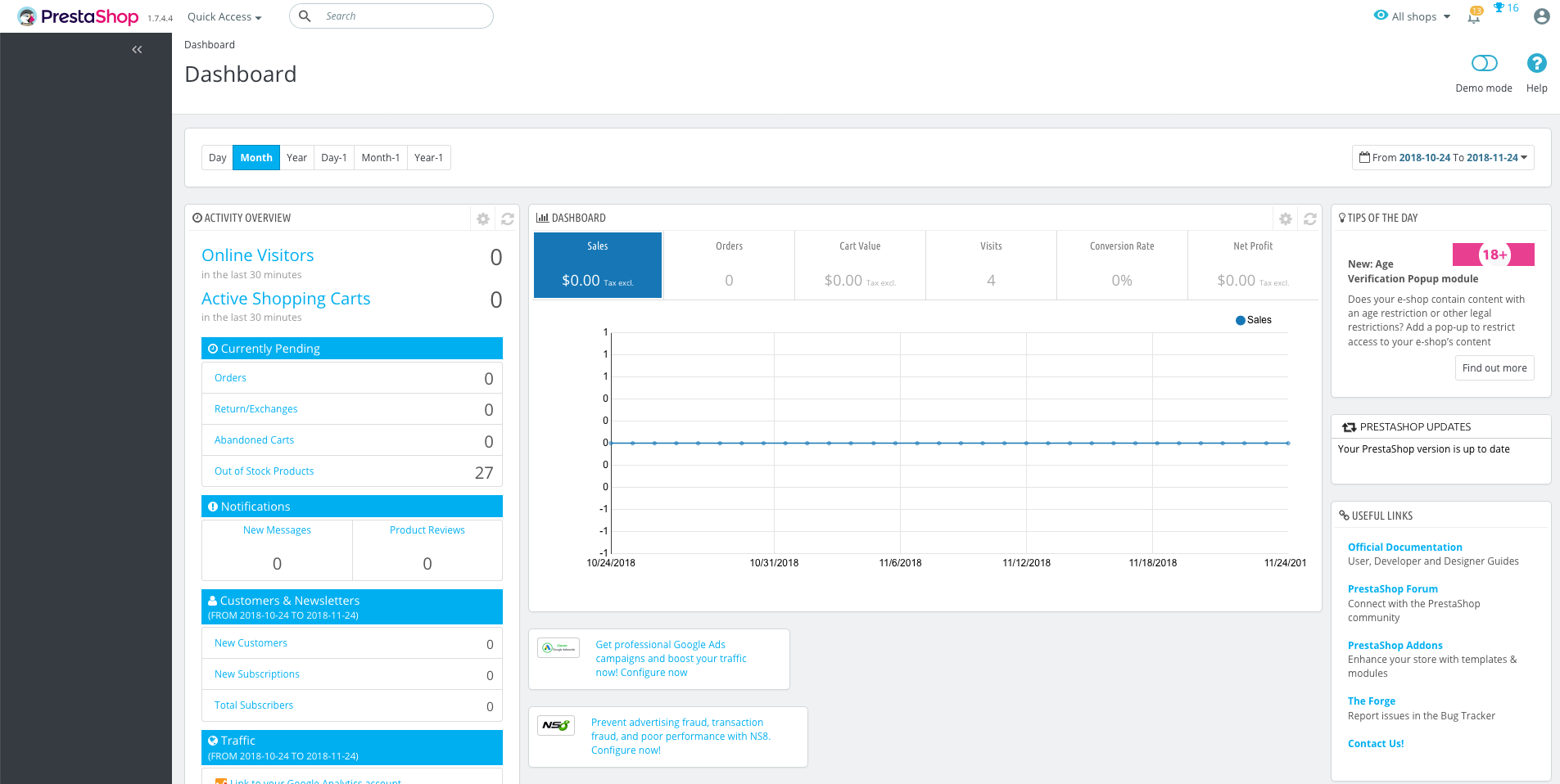

I tried to upgrade from version 1.7.3 to 1.7.4.4 using the manual upgrade method and 1-Click-Upgrade module. Everything is perfect on frontpages but some of admin navigation panels are blank. You can see the blank navigation panels. All pages are blank except configuring pages.
Need your help guys.
926319714_EkranResmi2018-11-2416_49_40.thumb.png.39ce0d0ae01be4322e2a3b6cac77c23a.png
2131915577_EkranResmi2018-11-2416_50_06.thumb.png.9a082cbc77bbbe5fff35dbf9b9683670.png
684997058_EkranResmi2018-11-2417_22_31.thumb.png.875b5b5fde86379f94f15e5df628d000.png
