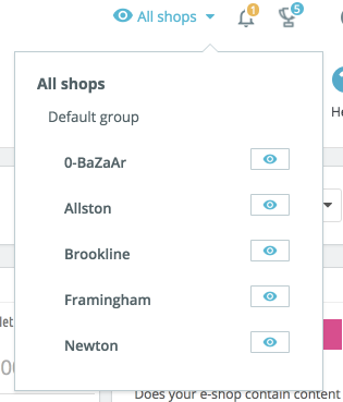

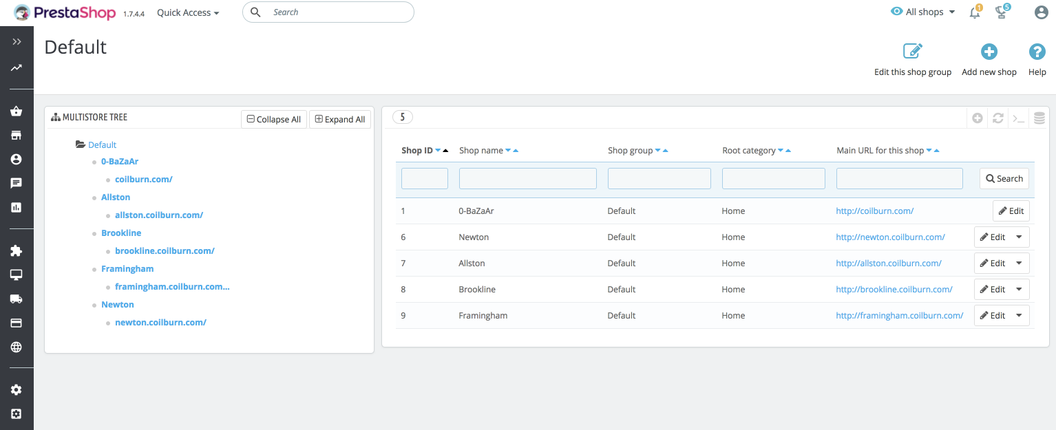

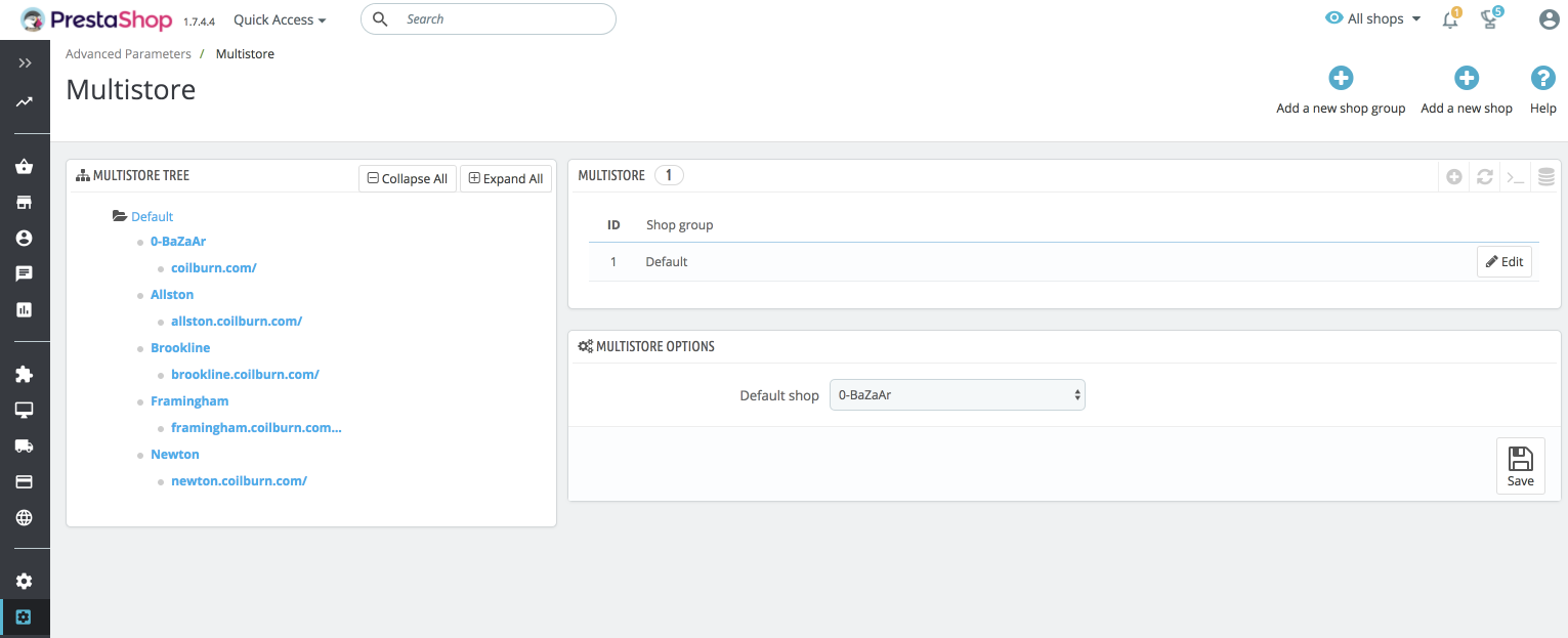

photomakes Posted November 17, 2018 Share Posted November 17, 2018 Hello. The first time I work with PrestaShop. The task is to make a multi store. Activated the multi store option and set up stores. Each store is created on different subdomains, and they have one engine. Trying to understand how the multi-store works, I ran into problems that put into a stupor from such a work of the engine. In the section "Advanced Parameters / Multistore" in the "MULTISTORE TREE" block, we got the following structure. Group "Default" – Store (in fact, is not a store, but an information platform, with links to stores) --- Store Url: exampleshop.com – Shop 1 --- Store Url 1 (shop1.exampleshop.com) – Shop 2 --- Store Url 2 (shop2.exampleshop.com) – Shop 3 --- Store Url 3 (shop3.exampleshop.com) – Shop 4 --- Store Url 4 (shop4.exampleshop.com) Scrn: 1. 2. That's what I don't understand. At the top right there is a drop down list with stores. Scrn: Opposite each store there is a button, clicking on which, should go to the main page of the store (to the store itself, and not to the admin area of the store). But, all these buttons on against the name of each store lead to the main URL. Also, in this list, which is shown when you click on the button on the upper right of the admin panel, when you click on the name of the store, in theory you should get into the admin panel of the selected store. Sometimes this happens, sometimes it even redirects to the admin panel from the URL of the store's subdomain. But in general, it is not clear in the admin for which store I am. When navigating the menu in the left block, the top right shows either the name of the selected store, or "All shops". How to make it so that in the block on the right above, when you click on the button of the selected store, the desired address of the store opens, and not the main URL? Does the transition to the admin of the selected store work correctly? Or have I encountered an error that can somehow be fixed? via: Google Translate Link to comment Share on other sites More sharing options...
El Patron Posted November 23, 2018 Share Posted November 23, 2018 I think the issue is that the main domain is not a store. When we add additional domains to a multishop, i.e. there is one installation with additional shops we point the additional shops to the main domain (a PrestaShop). When the additional domain enters the main single installation then MultiShop logic handles he request for that domain. Note: via hosting or dns you will need to point the additional domains to the domain with PS installed... Hope this helps...el 1 Link to comment Share on other sites More sharing options...
