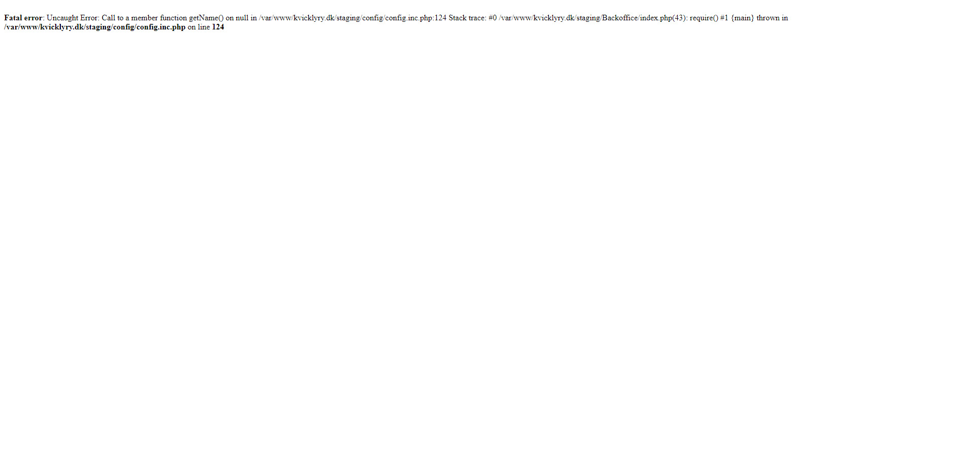

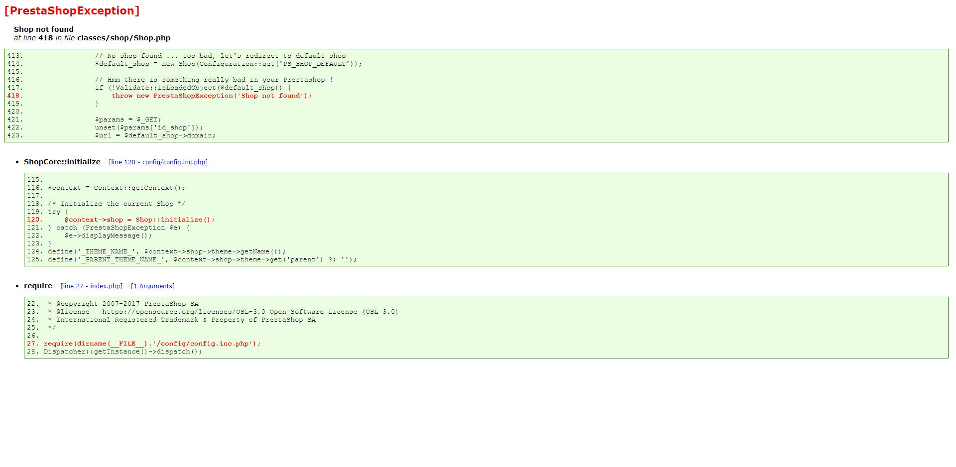

henrikkruse Posted November 8, 2018 Share Posted November 8, 2018 Hello First of all – I'm a newbie to Prestashop – but I have solid experience with Wordpress and other cms, so i have pretty good basic knowledge of cms systems.. Second of all – i'm really desperate for help!! I was asked to work on a staging site and as i was looking through the categories etc. the site crashed. I didn't do any major changes or saves as i was only browsing the backend to learn more about Prestashop. And boom the site crashed and hasn't been up since. I've spent hours the last two days trying to do a localhost version of the staging site, with no luck at all. I can't seem to make the databases work. So i need help defining how to solve the following error messages. Please see the screenshots; one is frontend and the other backend. Let me know if you need more details, i'll be sure to answer as best as i can. Thanks a lot! Link to comment Share on other sites More sharing options...
razaro Posted November 8, 2018 Share Posted November 8, 2018 Hi and welcome to the forum. You really got strange issue. You did not mention what is version of PrestaShop you are using, but check first in database ps_configuration table. Try to find PS_SHOP_DEFAULT as name and check what is in value column, should be 1 . Also check ps_shop table. 1 Link to comment Share on other sites More sharing options...
