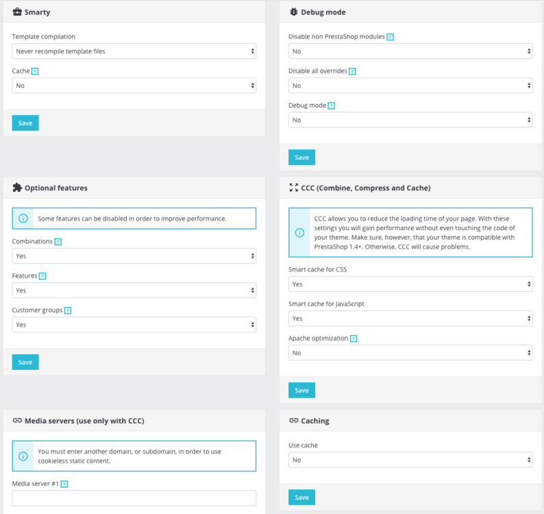

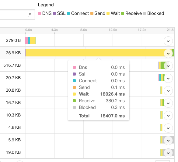

Simetria Posted October 19, 2018 Share Posted October 19, 2018 (edited) Why is my site running soooo slow?!? I have a custom theme on the site, but even with the default Prestashop theme it's so slow to load in every page – including basic pages such as about page. I know that I can benefit from adding a good caching module, but would site really be this slow even without the module? Simulating on pingdom.com takes 19 seconds to load the index page. 19 seconds!! images are not that large, and even if I disable the modules that use images, it does not help any. My server specs are : RAM: 19GB PROCESSES 1,500/min MEMORY: 768MB PHP VERSION: 7.1 See the attached image from pingdom – the long yellow wait time is for the index.php file In the backend I'm really confused how to setup the performance page... I read some blogs saying that Smarty caching is bad for performance, some say it is good. See the other image of the setup in my performance page. Any feedback would be greatly appreciated. Thanks. Edited October 19, 2018 by Simetria (see edit history) Link to comment Share on other sites More sharing options...
El Patron Posted October 19, 2018 Share Posted October 19, 2018 smarty cache is not enabled, that is big impact https://www.screencast.com/t/NbAI9h1B apache optimization should be set to yes....this has to do mostly with mod_expires https://www.screencast.com/t/o6Muy4BIJs re cache modules, we have a lot of PS experience and one of the biggest issues clients coming in the door have are 'directly' related to vodoo cache modules...they break the cart to the point you don't even know it. WE DO NOT RECOMMEND CACHE MODULES PERIOD. enable per above and the review your performance reports. happy optimizing, el For professional optimization services click here. Link to comment Share on other sites More sharing options...

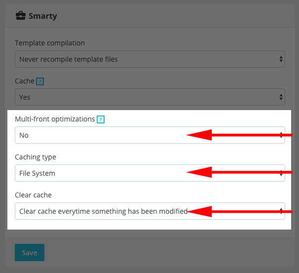

Simetria Posted October 19, 2018 Author Share Posted October 19, 2018 Thank you El Patron!! Quick question what should I choose for the other options inside SMARTY once "Cache" is turned on? -S Link to comment Share on other sites More sharing options...
El Patron Posted October 19, 2018 Share Posted October 19, 2018 1 minute ago, Simetria said: Thank you El Patron!! Quick question what should I choose for the other options inside SMARTY once "Cache" is turned on? -S those settings are fine. Link to comment Share on other sites More sharing options...
