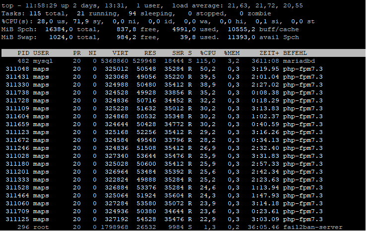

We are encountering a problem on a 1.6.1.18 shop (but the problem might have been there before this version as we are just now managing this website) : when the Prestashop Smarty Cache is enabled, after some time or after something is triggered, the PHP-FPM instances start to overload the server and finally render the site inaccessible.

When the shop is using the Smarty Cache (filesystem, not database), at seemingly random moments, the PHP-FPM processes start to overload one after the other until the server gets a load average so high that the website can't be viewed any more. The only solution at this stage is to restart the php-fpm daemon and then the site works again until the next occurrence of this phenomenon. The only way we found to avoid this all together has been to disable the Smarty Cache, but that's not a good solution.
We can't pinpoint what conditions are causing this problem to appear nor why it's happening. We tried to replicate it on an other server simulating a load on the website, adding and editing products, triggering CRON jobs, and so on, without success. From that, we gathered that the problem must be triggered by a load specific to the daily use of the shop (visitors, orders, admin actions, cron jobs, modules calling external APIs for delivery or abandoned carts, ...).
When the problem occurs, what is apparent is that the PHP-FPM processes are trying to fetch or remove template cache files from different modules very rapidly and in a seemingly infinite loop. We found that by running a trace (using `strace`) on the processes. The queried paths vary from one occurrence to another and even during the occurrence, so there is not definite culprit that can be identified among the modules.
