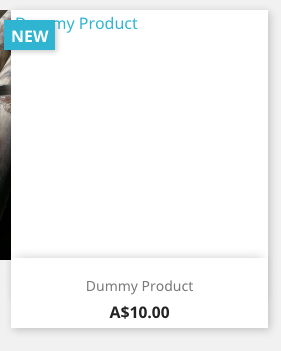

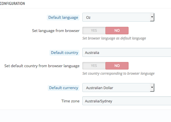

cmroanirgo Posted October 14, 2018 Share Posted October 14, 2018 (edited) I'm a bit stuck trying to figure out why my store keeps displaying all my prices with an 'A' in front of them, eg 'A$1.00' rather than '$1.00'. The store is for Australia and have set everything I can find to be Australian. Debugging the code (using XDebug), I find that src\Core\CLDR\Repository.php getPrice() is still thinking that my locale is set to 'en-US'...And this is where the problem really is.... because in the 'culture' tables for the US, it says that Australian currencies should be displayed with an 'A' in the front of it. (It's wrong btw: it should display AUD afterwards... but that's beside the point). I've tried: - "Localization > Import a localization pack". It seems to do nothing - Creating my own 'Language' with country code 'OZ' (a nonsensical one) and region as 'en-AU' (I've tried en and AU variants too) - Deleting / Creating a currency - In "Localization > Configuration" I have set Langage (Oz), "Set Language from Browser" AND "set default Country from browser" to FALSE, Default Country is "Australia", Timezone is Sydney Any ideas? Thanks, Craig Edited October 14, 2018 by cmroanirgo (see edit history) Link to comment Share on other sites More sharing options...

cmroanirgo Posted October 15, 2018 Author Share Posted October 15, 2018 @jstillings1 Thanks, but that's what the problem is. Selecting it shows the wrong symbol. Link to comment Share on other sites More sharing options...
