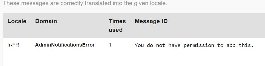

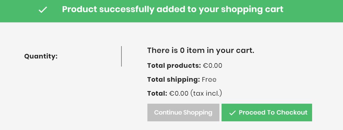

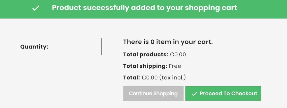

carrabsg Posted October 12, 2018 Share Posted October 12, 2018 Hello everybody, I'm a newbie in Prestashop. I nearly finished everything but I have a big problem since 3 days. I'm not able to add a product in the cart. I tried to install the new version of prestashop but there were too many bugs. I came back thus to the previous version. Maybe the problem come from that. I have a message in the debug mode, i'm not sure if it is useful (see attached). Could you please tell me what to do to solve the problem? Thank you very much G. C 1.7.2.4 Prestashop Website : https://acquadijerusalem.com/en/ Link to comment Share on other sites More sharing options...
