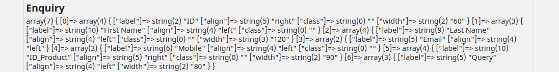

and the final output that I am getting is.  image1.png.0c3a7007d28cd837e7df822716531919.png
and I want the output to be like
Thanks in advance. please help I am really stuck in this.
Hi Ruman
Not sure if you are passing any value to tpl file. You have assigned $this->table_header and later
$this->table_content  but I do not think that is passed to tpl file.
Also I do not see you defined table_header and table_content as class variables.
Try to add
class ProductEnquiryEnquiryModuleFrontController extends ModuleFrontController
    public $controller_name = 'enquiry';
    public $module_name = 'productenquiry';
	public $table_header;
	public $table_content;
Than before $this->setTemplate pass values
$this->context->smarty->assign(array(
            'new_product_link' => $this->context->link->getModuleLink(
                $this->module_name,
                $this->controller_name,
                array('render_type' => 'form'),
                (bool)Configuration::get('PS_SSL_ENABLED')
			'table_header' => $this->table_header,
			'table_content' => $this->table_content,
Then in abaa.tpl try to see if those values are passed and if they are then make changes and read them in for  loop
{extends file='page.tpl'}
{block name="content"}
<div class="kb-content">
    <div class="kb-content-header">
        <h1>{l s='Enquiry' mod='productenquiry'}</h1>
		{$page_header|var_dump}
    </div>
    {$page_content|var_dump}
</div>
{/block}

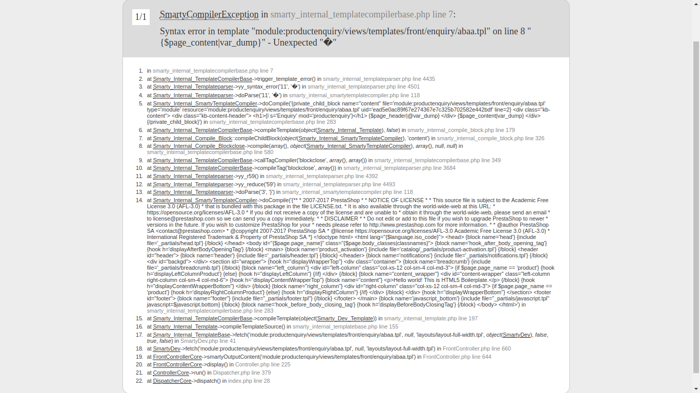

Hi  razaro,
Thank you for your reply. Your effort is appreciated but I would like to know some more details about it. This is not working for me. First defined the variable  public $table_header;
public $table_content;  and then passed values like this
                $this->module_name,
            'page_header' => $this->table_header,
            'page_content' => $this->table_content,
Then in abaa.tpl i am accessing like this
             {$page_header|@var_dump}
    </div>
</div>
{/block}
but this gives an error image3.thumb.png.b5598c70c673f4683b9eed15460c9054.png
but when I am removing     { $page_con tent|var_dump} line in my tpl file it gives the output as follows
 Thanks in advance

and in tpl
{$var}
in console log I receive success as a answer but I can't see in view?
What I'm doing wrong?
