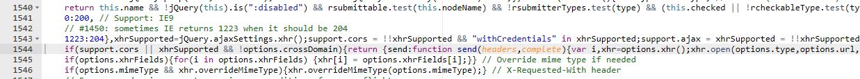

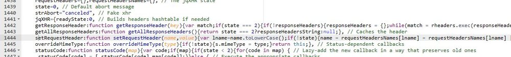

polaije Posted October 12, 2018 Author Share Posted October 12, 2018 I tested this issue with a site clone without cache and I found the error in …./themes/core.js:1544, see the img You can have it with presta17.pharmanovea.com Dont take the jpg error into account, the img are not at correct location. Link to comment Share on other sites More sharing options...

polaije Posted October 18, 2018 Author Share Posted October 18, 2018 One up on this issue... I finally understand why the problem of exiting the order occurs with Belgium, this is because it is designed as default country. On the order page, when we change the country in the address step, the button change from Continue to Save and the address confirmation page is loaded interrupting the order process. As Belgium is the default we dont have to change it. Is this the normal behavior ? If it is we have a problem having a small country as default. Concerning the xmlhttprequest error it occurs in themes/node.js at line 1544 and I Don't know if it has an effect on the normal order procedure. Link to comment Share on other sites More sharing options...
