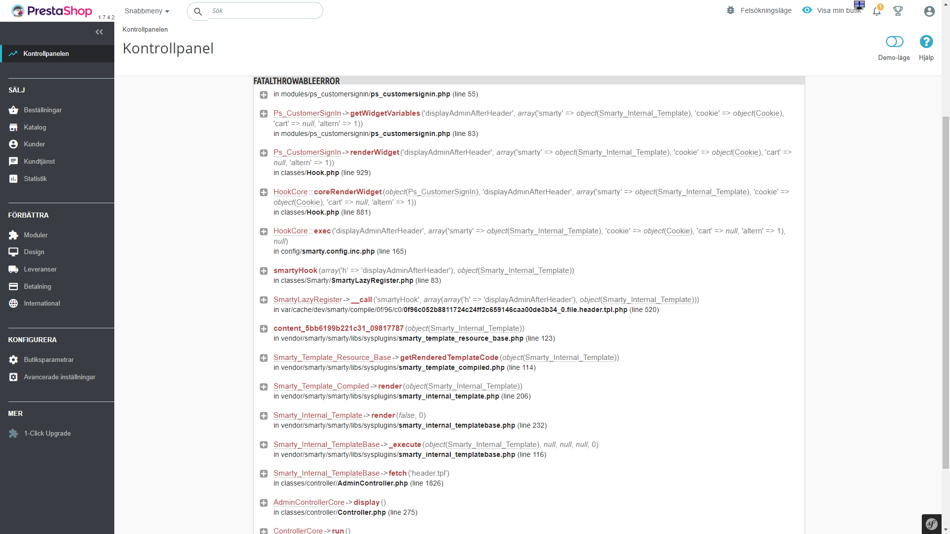

Matt Posted October 5, 2018 Author Share Posted October 5, 2018 Ok i get this message: Link to comment Share on other sites More sharing options...
Matt Posted October 5, 2018 Author Share Posted October 5, 2018 And the logs looks lite this Level Channel Message CRITICAL10:37:18 php Call to a member function isLogged() on null DEBUG10:37:18 doctrine SELECT name FROM psf_module WHERE active = 1 CRITICAL10:37:18 request Uncaught PHP Exception Symfony\Component\Debug\Exception\FatalThrowableError: "Call to a member function isLogged() on null" at /customers/2/e/f/ftg.se/httpd.www/foretaget/modules/ps_customersignin/ps_customersignin.php line 55 Link to comment Share on other sites More sharing options...
joseantgv Posted October 5, 2018 Share Posted October 5, 2018 It's weird, as if it is trying to execute module from backoffice. Try to disable module and then move hook. Link to comment Share on other sites More sharing options...

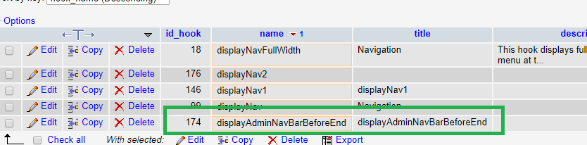

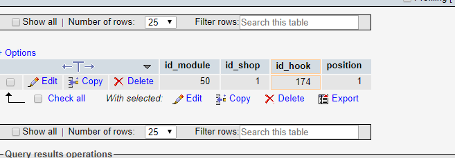

Knowband Plugins Posted October 5, 2018 Share Posted October 5, 2018 Hi, Do you have any idea of the phpMyAdmin (accessing DB table)? Entry can be deleted from the table to fix the issue but its a little bit tricky. I believe you have added the login block in "displayAdminNavBarBeforeEnd" hook. In the ps_hook DB table search for the displayAdminNavBarBeforeEnd. It will give you the hook id. You will get ID like 174. Now search 174 (In your case it may be different) in ps_hook_module table in id_hook column. In my case, there is one result but I believe there will be 2 entries in your case. You need to delete one entry (Most probably 2nd one). Kindly ensure to take the backup of the DB before deleting the same. Link to comment Share on other sites More sharing options...

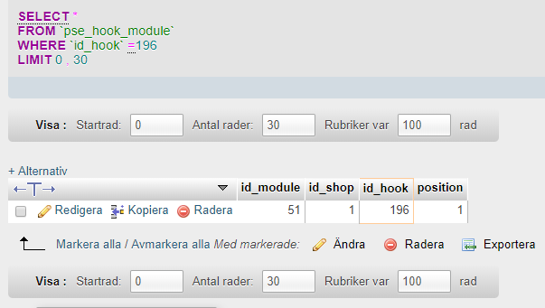

Matt Posted October 5, 2018 Author Share Posted October 5, 2018 Thanks Knowband Plugins! It was just one entries not 2 unfortunately. I did what you tell me. And there was only one entries Link to comment Share on other sites More sharing options...

joseantgv Posted October 5, 2018 Share Posted October 5, 2018 29 minutes ago, Matt said: Thanks Knowband Plugins! It was just one entries not 2 unfortunately. I did what you tell me. And there was only one entries You can also fix it by database. If module ID 51 is ps_customersignin (check ID it at ps_module table) then change id_hook to nav1 (check ID at table ps_hook). Link to comment Share on other sites More sharing options...
